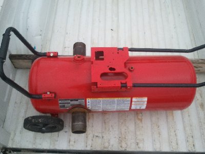

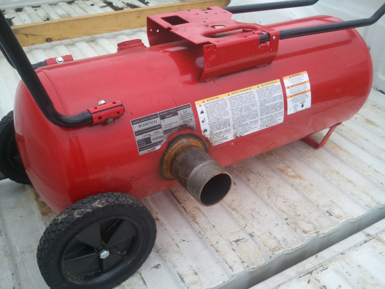

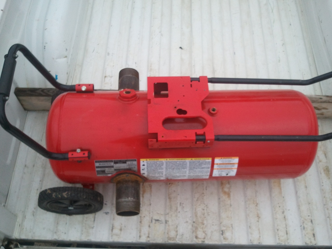

I got the 3" nipple welded in place. Not too shabby. Despite what it may look like, it is actually in there almost perfectly perpendicular.

Fri Feb 25, 2011 3:23 pm
Looks like you have lined them out pretty well.
Are you leading the pipes all the way around the tank?
(not the most efficient design)
Jimmy K
Posts: 173
Joined: Wed Jan 20, 2010 9:17 pm
Sat Feb 26, 2011 7:27 pm
With 1 tank, 2 valves, and a tee, the shortest path would include 2 elbows (including the valves themselves). The tee is going to be parallel to the two ports, just about 6" above the tank. It would be a lot more efficient if I had a pressure rated wye or manifold, but they are nonexistent.

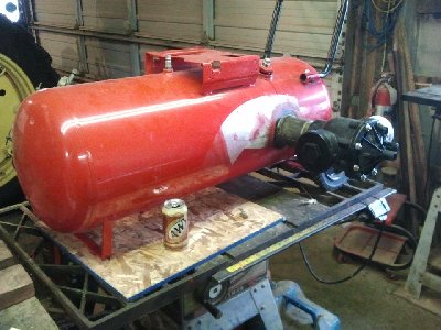

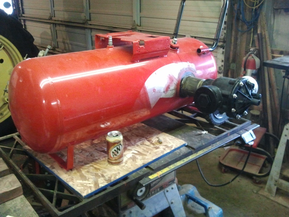

Here is the tank with the valves.
That is not the final position of the valves - they are on there simply for the ongoing pressure tests.
And I included a root beer can for comparison this time.

Fri Mar 04, 2011 5:32 pm
:D
It definitely puts things in perspective.
Have you thought of putting some sort of wedge shape in the center of your Tee to help direct the airflow towards the barrwel and minimize turbulence?
so many muchness
