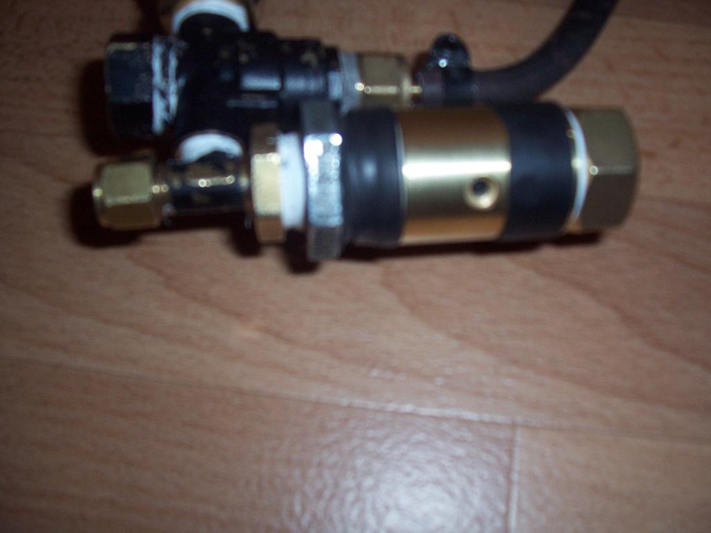

20 bar snap-open valve.This sucker would be awsome as a full auto bb valve alone!!<br />I name it: the Snapvalve <br />It CAN NOT EVER open slowly.Once the pressure escapes the outlet, it hits a large diameter piston wich due to it's large surface area, is forced open against the , by comparison, much weaker spring.<br />The cap can be used to tune the power.Offcourse it's crewed on to the max...

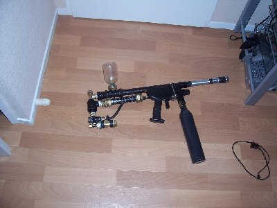

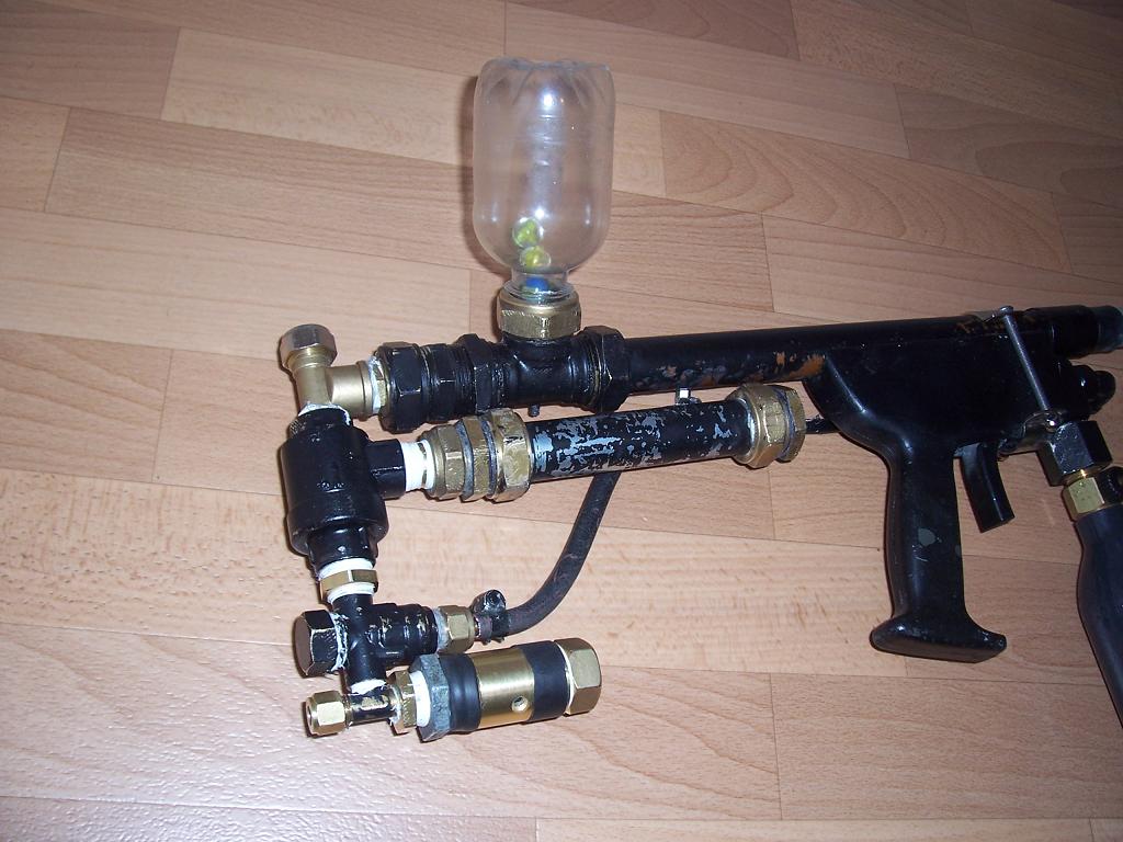

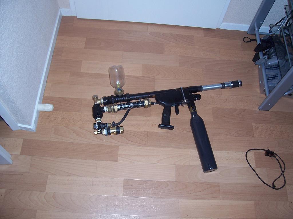

Overall look...I am thinking about attaching elevated sights.<br />You can clearly follow the path of the gas.Going up from the bottle , it goes through the pressure washer handle.It enters the back through a hose, goes into a 3/8 ballv.( stipped of it's handle, wich also hold the custom made pop-off.Through the QEV it reaches the reservoir.
I like the bottle hopper.THe entire gun is quite complex, but still very compact.

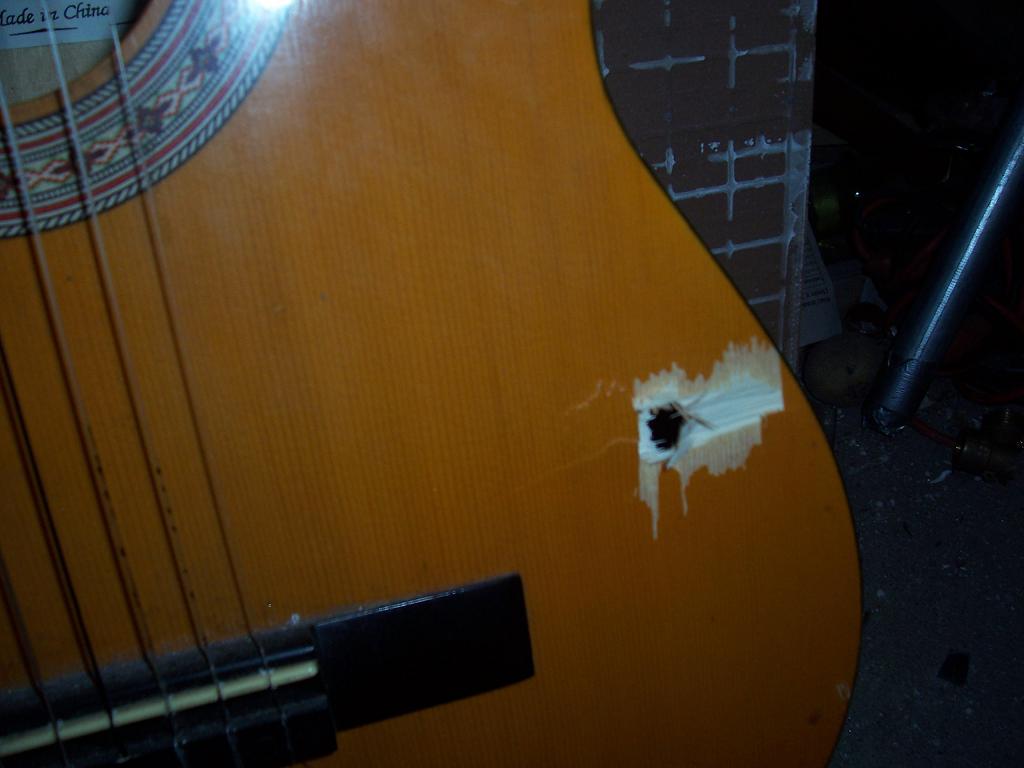

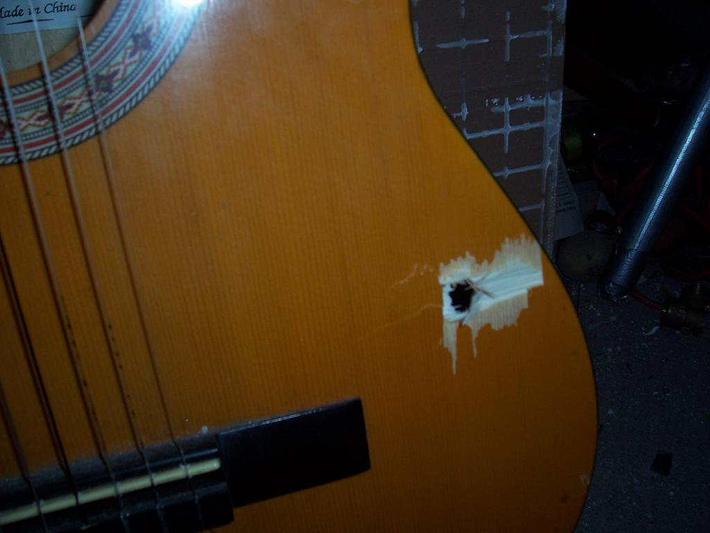

Damage to a cheap guitar.THe lower hole was with the new pilot valve, the above ( not penetrated) was before.

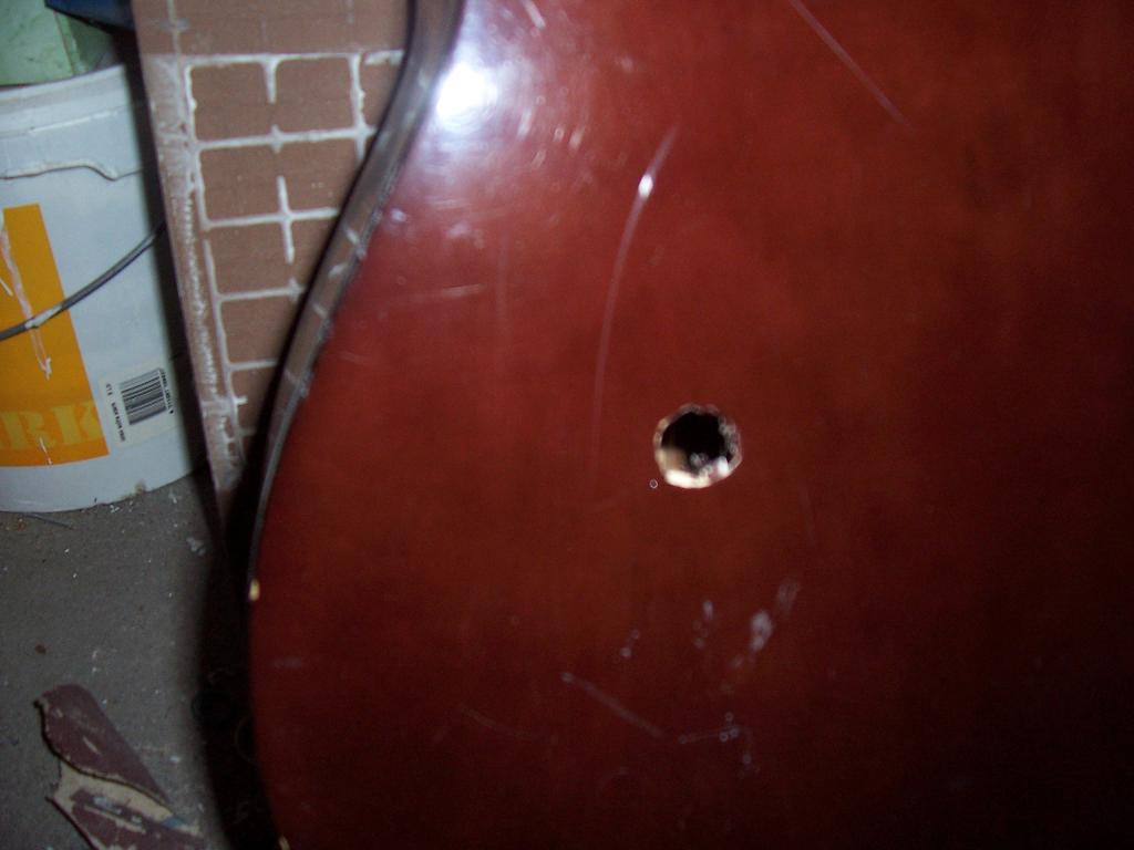

Close up of a perfect round hole.<br />This guitar was always out of tune ( poor quality) and had tosuffer the consequences..

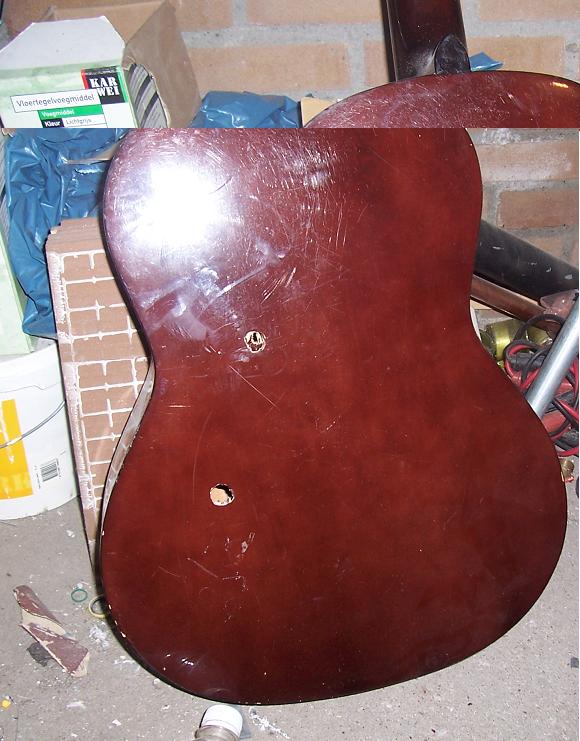

And the exit hole..The guitar was no problem for the marble.I can't wait to try this with a full hopper and a bottle'full of gas!( I'm scared to try actually)
