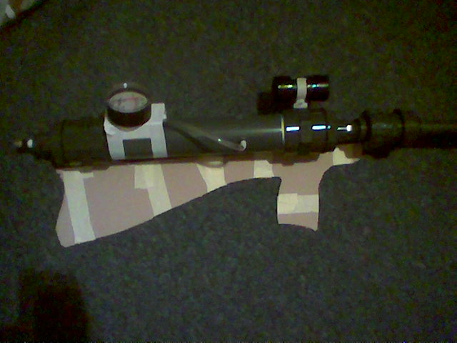

For all those interested the E-444 is getting some improvements. Mainly a stock.
Its is similar to the the barett's stock only curvier. To find the right position to mount the grip and butt, I found the point of equilibrium of the gun by balancing it on a a broomstick, then I marked this point, luckily it ended up exactly under the front reducer where the scope is mounted. I did this to make the gun more balanced and therfore more "pointable".
I measured the distance from my hand to my shoulder when my elbow is at around 60 degrees to give me the length of the stock and position of the recess. I marked this on the gun also.

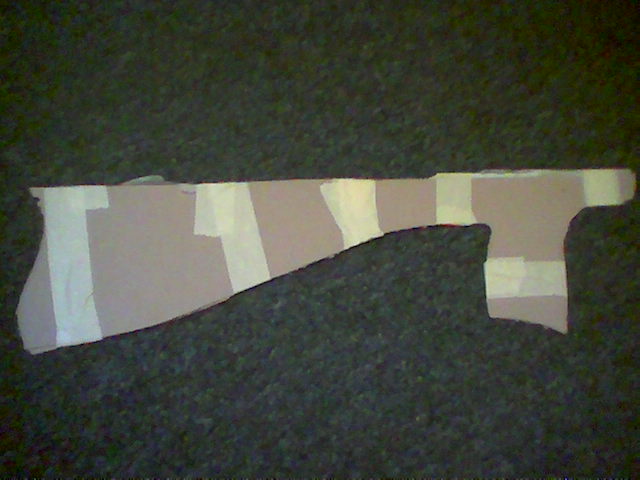

Next I made a rough sketch of the design and proportioned it accordingly with the previous measurements. I drew it up on card and cut it out.
I am now going to use this cutout as a template cutout the same shape in two pieces of heavy plywood, which I will glue togheter later. I will then sand down the sharp edges and maybe give it a coat of white spray paint, to act as an undercoat for a later paintjob.

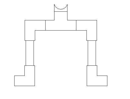

Once the stock is done I am going to make the Bi-pod shown whose legs can swivel on the tee junction, this way it will fold up and down.

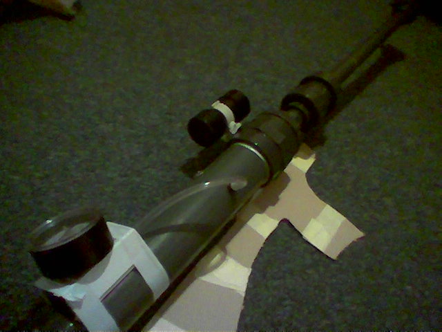

The shape of the stock.
The cutout shown has a slightly shorter stock then the proper on I made, other than that they are identical.
The cardboard stock cutout,
This is the shape of the bipod.

I'd use a Saddle Tee with a Tee and 2 45's for the bipod...
The grip could be made out of a Saddle Tee also...
-FrOgY-
