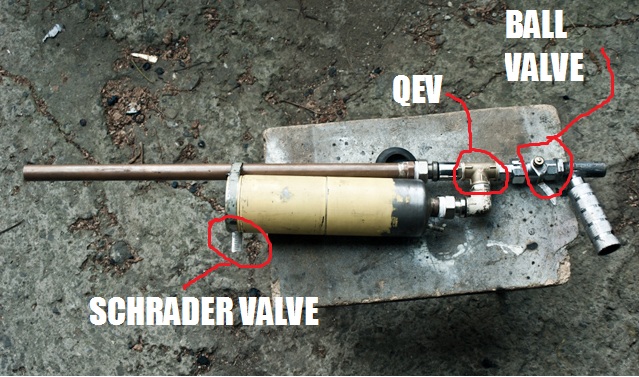

also, is this correct?
Pretty much, except that what you marked as a schrader valve is actually part of a jubilee clip, the actual schrader is on the other end.
In the case of the launcher illustrated, the QEV is homemade.
Oh derp, I see the schrader valve now!
