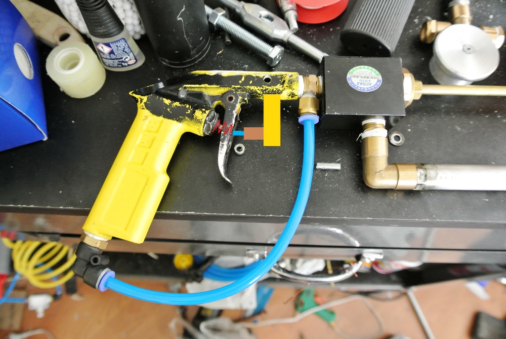

Here goes probably the worst diagram I've ever made.
The idea is instead of drill the exhaust port on the nozzle of the blowgun, drill just one hole and epoxy a tube on it (yellow part) with a tire schrader valve(brown part) epoxyed on the tube pointing to the trigger. Then glue a m3 screw (light blue) on the trigger the way it could push open the schrader valve. The spring (red) is there to push the trigger forward so the screw can keep the schrader valve open also when you pull the trigger, the schrader valve will be closed before the trigger starting to open the blowgun valve.
So when you pull the trigger, the schrader valve is shut, the air only fills up the space of the nozzle of the blowgun giving a short burst out of the QEV, when the trigger is released, blowgun is shut and the screw pushs open the schrader valve to exhaust the trapped air inside the nozzle.
Here is what I have now, fires .177 pellets and arrows. It's way louder in real life

A pop off will give you full auto if you don't close the blowgun fast enough. For semi auto you need to have a shut space to temporarily storage the air for the QEV to give a burst and only exhausted after the blowgun has closed. A pop off will open the same time you pull the trigger, not afterwards.

For semi auto i would suggest a 3 way valve, filling the air chamber through the pilot in the resting position, and shutting off the air supply and venting the pilot area when you actuate it.
You can also include a single acting cylinder in this concept, loading a round to the barrel after each shot
