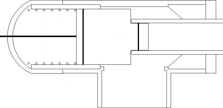

I think I finally figured out why this type of valve has intrigued me so much. It is because this is what I was trying to do a while back. I just couldn't get it down right. But, thanks to Tech, I have since been able to accomplish this.
What I was trying to do is to put a spool type valve in a tee and have it function very similar to a piston valve, while still being more efficient, easier to maintain and operate, and simple to build.
- Here is a sketch of the valve I was trying to put together. Once it is built, I may even contribute it to ya, Tech.....
- Hubb QDV.JPG (22.17 KiB) Viewed 21647 times
- spudtyrrant
- Corporal
- Posts: 550
- Joined: Fri Jan 02, 2009 6:10 pm
i see a problem with that design hubb where are you going to find a spring strong enough to hold that piston closed. techs works because the air pressure is pushing the side and therefore the valve is neutral with your design the piston is being pushed back by large amounts of air pressure and i don't think it will work
I do see the concern, but that above is just a rough sketch. When time permits, I can draw up a better scaled diagram, which should all but eliminate that problem you described (I supposed I shouldn't have exaggerated it that much, huh?)
Another thought I have, is to eliminate the rod altogether and add a sear.....
It is ironic that I too have been working on a QDV design using a Tee configuration. Just have to do finalized CAD drawings.Hubb wrote:I think I finally figured out why this type of valve has intrigued me so much. It is because this is what I was trying to do a while back. I just couldn't get it down right. But, thanks to Tech, I have since been able to accomplish this.
Should be done in a few days so everyone including Tech can critique it!
We can then compare notes.

Beautifully rendered schrader valve there
- Technician1002
- Posts: 5189
Very nice drawing. may I suggest extending the bumper toward the piston so the piston can't strike the reset ring on the rod? It needs to retract out of the way before the piston starts to move. When it moves, it goes back until it hits something. It should hit the bumper first.Labtecpower wrote:I made a drawing in auto-CAD, colored with paint.
Maybe this makes the whole QDV even easier to understand?
Click on the picture to view full size!

I still have the CAD-file, so a modification is easily made.
I forgot to draw a bumper. The reset ring should retract into the bumper.

Improved version:
Now with a reset rod not perforating your hand, and a bumper

- Technician1002
- Posts: 5189
Mine retracts all the way through the bumper and beyond it before the valve opens. This prevents impact if the bumper compresses more than expected.

I don't think there will be any problems with the piston hitting the reset ring.
If the piston opens, the ring is retracted into the solid tube, beyond the bumper.
