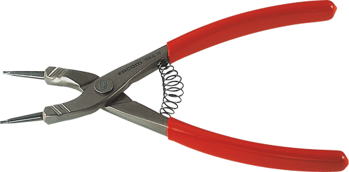

I used a tool like this:
Stuck the schradder valve in a vice, and unscrew the little block inside.
It may be hard to unscrew.
My valve wasn't a threaded one, it's a tubeless, exactly as killerbanjo's.
