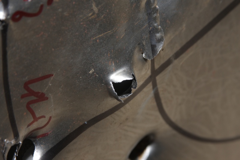

Very nice, is that the barrel from a muzzle loader/ black powder rifle?
Petitlu
Posts: 807
Joined: Fri Jun 03, 2011 4:52 am
Thu Sep 29, 2011 4:29 am
yes, barrel PN
I bought the barril with loading by the mouth at Dixiegun
There it is a shooting without shear disc

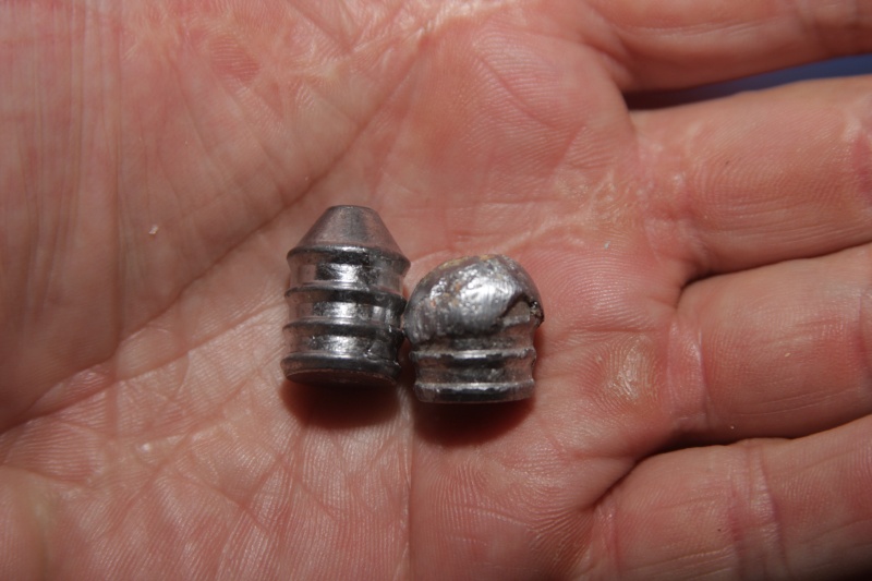

Petitlu wrote:I bought the barril with loading by the mouth at Dixiegun
Brilliant, we've often talked about using black powder barrels but I don't think anyone has ever implemented it before. Also being nice and long it takes full advantage of your large chamber.
Have you done any longer range accuracy tests shooting from distances of say 50 and 100 metres?
Did you notice a significant power drop when shooting without the disque de rupture?

I am modifying my PAC (balance of the masses) in order to be able to draw with long distances to measure the precision.
Without the shear disc, the power is divided by 2…
Highly shootings with 200 bar!
