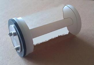

*Weightgyrotech wrote:The piston is made from UHMW. Ultra High Molecular Wear.
Yep, pretty hardy stuff. You should be fine.You can smash this "plastic" stuff with a hammer all day long. It will not shatter. It might deform a little.
I would trim out the piston to some extent, to maximize performance and minimize impact energy.
Here's a shítty artist's impression of what it might look like
- piston.JPG (8.37 KiB) Viewed 6448 times
