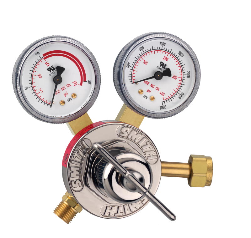

0-30 PSI regulator.
0-30 PSI regulator.

Great post, Technician1002. I just wish I knew what the abbreviations meant. Still a noobie to this stuff.
