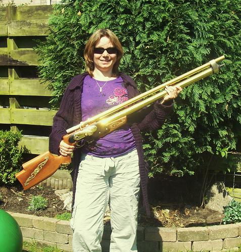

" Old Shatterhand" 5 shot mag now cycling on vid.
- Brian the brain
- Posts: 3497
- Location: Holland
- Been thanked: 7 times
Nice swearing JSR!
It indeed exceeds my expectations....
The best cannon I've ever built.Even my wife likes it.
She never liked any before...so that's a big succes!
Now, I still need to make the barrel band, or support if you will.( edit: done)
I have put a triggerguard on there, but that's nothing special.
I'll replace it with a better one first chance I get.

The only kind of video worth watching I could make without waking the baby...
And evidence my wife likes it:
( first time ever!!)

Brilliant, certainly makes Mrs. BtB look ready to kick some ass

You should hear her talk....certainly makes Mrs. BtB look ready to kick some ass
Still the other way around I'm afraid...I wish I had his workshop...good enough to make Gary Barnes jealous
