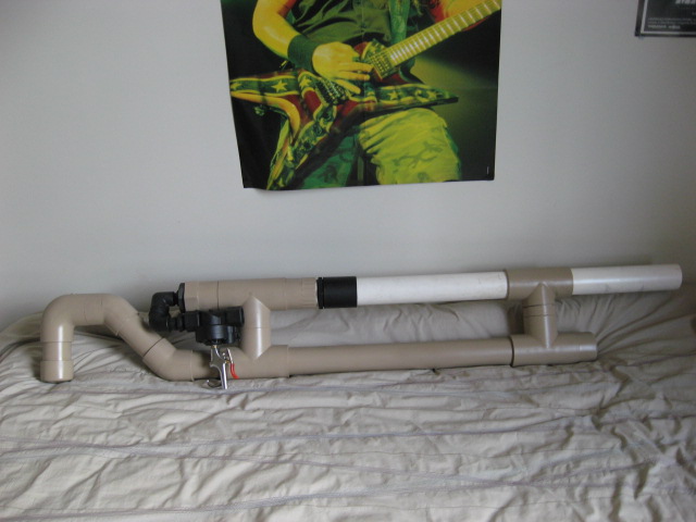

Well here's the cannon after a new upgrade/downgrade as i've removed the stock. Paintjob has suffered a bit and I just realised it has almost been two years since I posted the cannon.
Over View
Close up of piston housing, pilot setup and removed stock
