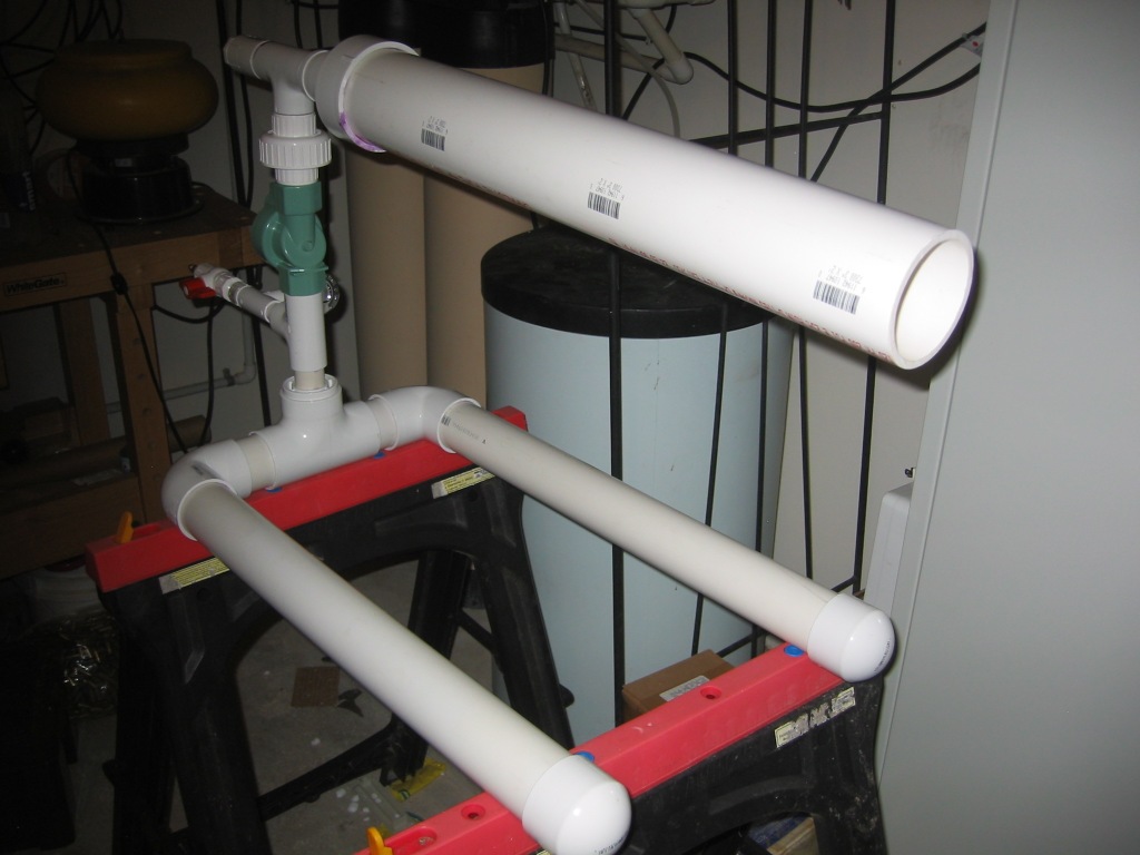

Name: CA3 PDAB (Cannon Assembly Mk. III, Pre-Determined Air-Burst)
Type: Single Shot Pneumatic Cannon, Interchangeable Upper Section
Loading Method: Muzzle Loaded
Barrel Type: 2' by 3" Sch40
Chamber Type: 2' by 2" Sch40 (2x)
Operating Pressure: 30psi-100psi
Fire-Control Sys: FA-E1B NCS
Ammunition: 75mm M2 Shell NAABFW, 75mm 'Skipper' Anti-Materiel
# of Valves: 1
Type of Valves: Stock Orbit Watermaster 1in Sprinkler, Solvent connectors
Sights: None
Projected Improvements: Build additional upper Modules, including Breach Loaders, Small Diameter Barrels, and others.
The CA3 PDAB is a cannon developed under the WC-AB Project to fire specially designed 75mm airburst shells. Designed with ease of reloading in mind, the entire barrel and cable compartment are secured to the valve/chamber assembly via a union. This allows for the use of a number of different barrels and ammunition, but the main feature is its ability to fire a specialized airburst shell, the 75mm M2 Shell NAABFW (Non-Adjustable Air Burst Flour Warhead). Secured to the cable compartment with a large nut, the cable pulls on the shell when it pull tight, triggering it to open. Its secondary armament, the 75mm 'Skipper' Anti-Materiel round, is nothing more than a long water bottle filled with water. Launched at 90psi, it travels about 50' before hitting the ground and skipping, maintaing sufficient kinetic energy to knock over sandbags, useful for taking out unmanned fortifications. It uses an upgraded variant of the FA-E1 NCS, the FA-E1B. The 'B' model makes up for the shortcomings of the initial model, adding a second battery and a SP-ST safety.

Nice work, but, scrap the bell reducer. Replace with a bushing / coupling combo.
THUNDERLORD
- Posts: 1264
Nice post.
A barrel support would definately be a good idea.
The recoil puts stress on the connections ( The barrel flex can be seen in the vid).
I wouldn't want to use it without a barrel support.
Or with the bell reducer (already mentioned).
Other than that looks like a nice test platform for various stuff. 8)
BTW, you could also mount it on wheels inside the doghouse in vid, paint the doghouse blue and white and change the name to c3p0 instead of CA3 PDAB

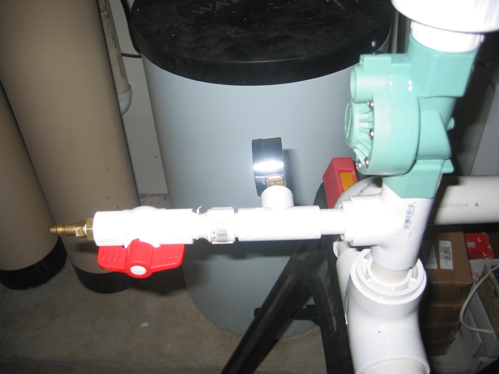

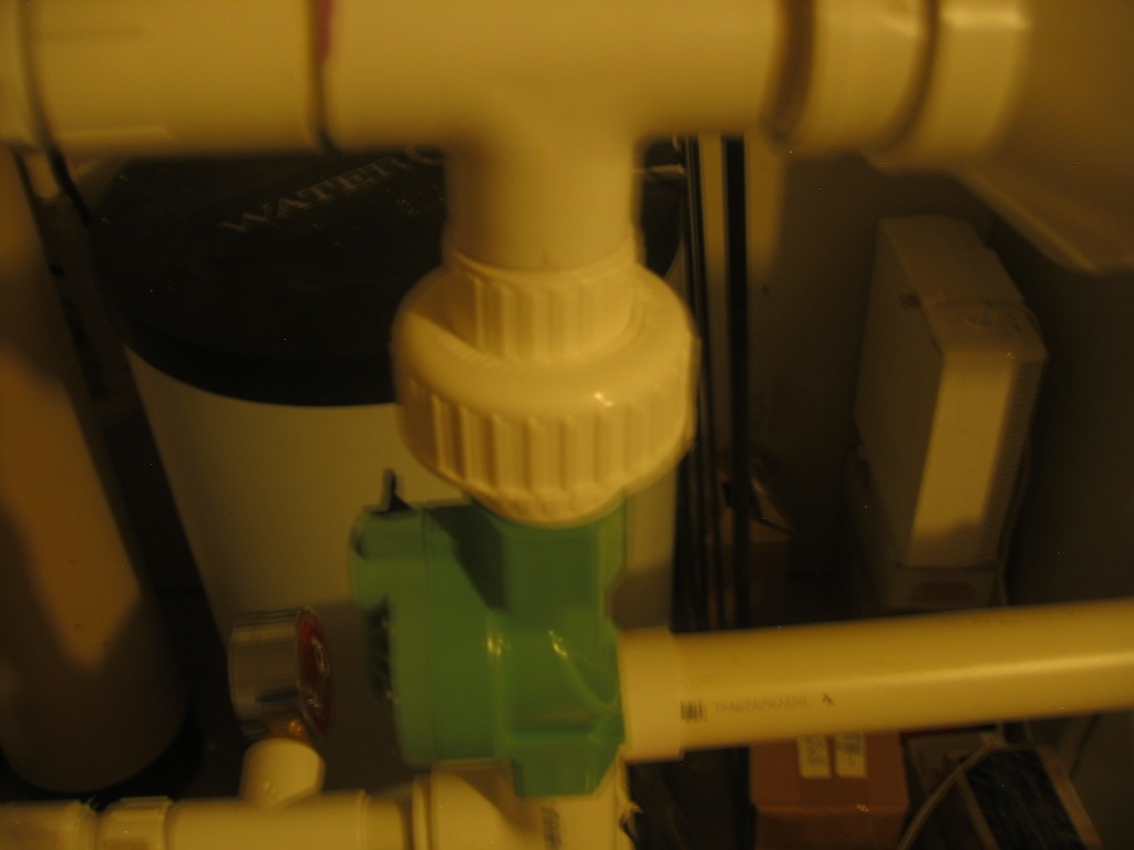

I agree with you that the bell reducer in this application will be under much less stress...but...
You are using your sprinkler valve as the sole structural support between the chambers and barrel. The design also makes any proper barrel support fairly large, but something you should add on there soon to take the stress off of your 1 1/4" feeder and sprinker.
It's little gangly looking but you're generally getting the job done there. When do you plan to shoot a real airburst?
Good job with the detailed post!

Nice, and interesting design, im curious though, do you have canaries? I can hear them in the background pretty well.
Back on topic, i would have chosen a different design, only because of the stress on the valve and the fittings, but its ok and looks fun and portable.

Yeah, I know. Bell reducer DWV blah blah blah, doesn't really matter in this cannon. Yes, support would be nice. I MAY build some. And I MAY actually have to put it in the doghouse. That just sounds fun. BTW, this crazy piece of crap takes forever to fill off of my 3gal compressor. God, it's like 10 minutes between shots. Besides that, I'm fairly pleased with it. Also, I am happy that the line I will be using is rated for 370 pounds of force.
BTW, I may take a break from new crazy ideas (*cough*autocannon*cough*) and just build a simple, easy to design, QUICK TO FILL, airsoft cannon or mortars by the buttload or something.

Sorry I just have to quote you on thatBell reducer DWV blah blah blah, doesn't really matter in this cannon
dwv is not blah blah blah, it is serious. All your cannons are an extreme danger to operate and I wouldnt want to be anywhere near it when you were charging one up or firing.
I know that it is under pressure for only a short amount of time but that doesnt mean it wont go boom or fly off, esspecially with the heavy ammo you are using. But in your other cannon the dwv is under a constant pressure which is VERY dangerous.
You assume that it is fine because it hasnt gone boom on you yet, but its only a matter of time before it does.
