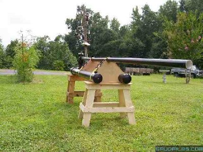

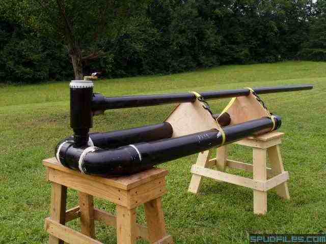

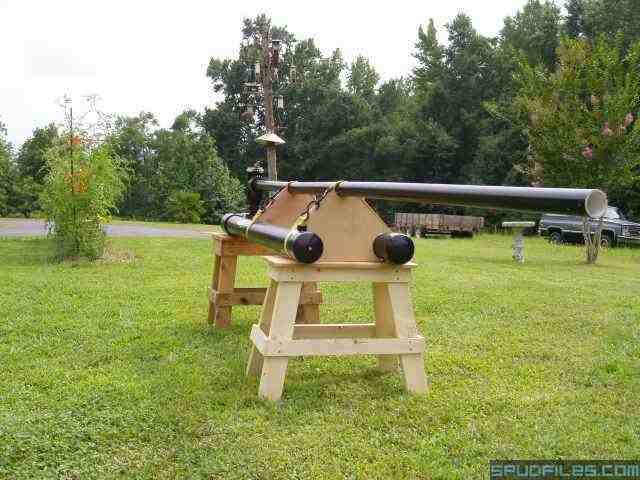

Here is my launcher.&amp;amp;nbsp; It is a pneumatic cannon.&amp;amp;nbsp; The chambers are 4&amp;quot;x5' sch40 PVC and the barrel is 2&amp;quot;x10ft sch40. The valve is a standard supah valve with ball valve actuation.
Here is my launcher.&amp;nbsp; It is a pneumatic cannon.&amp;nbsp; The chambers are 4&quot;x5' sch40 PVC and the barrel is 2&quot;x10ft sch40. The valve is a standard supah valve with ball valve actuation.

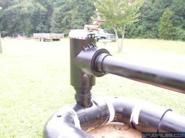

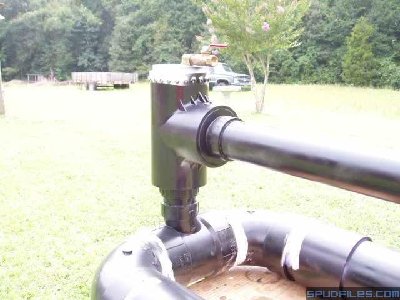

Here is the supah valve. The elbows are 4&amp;quot; and the tee is a 4&amp;quot; to 2&amp;quot; tee.
Here is the supah valve. The elbows are 4&quot; and the tee is a 4&quot; to 2&quot; tee.

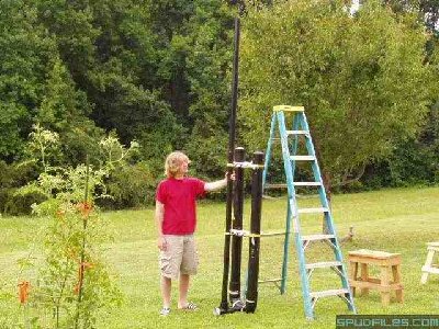

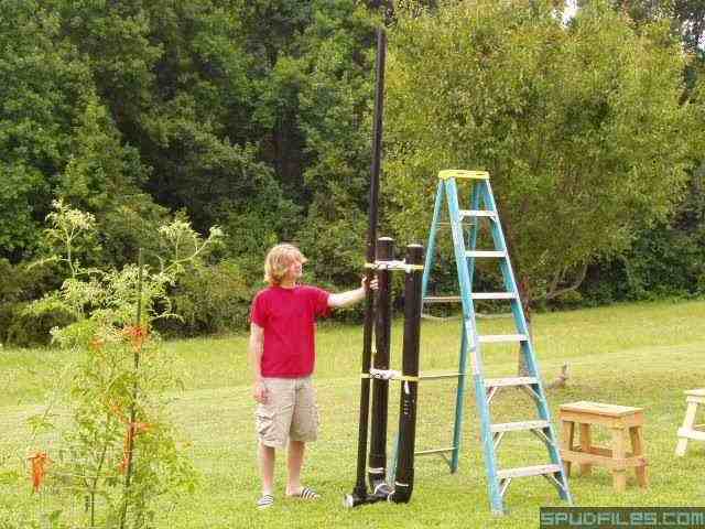

This shot gives you an idea of the scale of the gun. That is my friend Buck holding the gun.

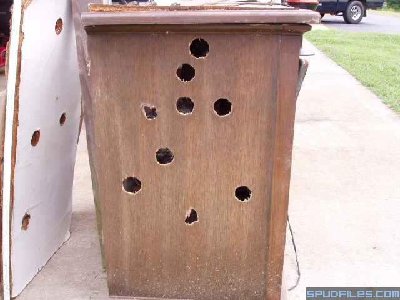

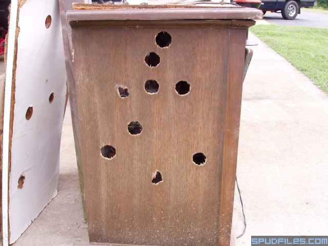

Here is a tv we found on the side of the road.

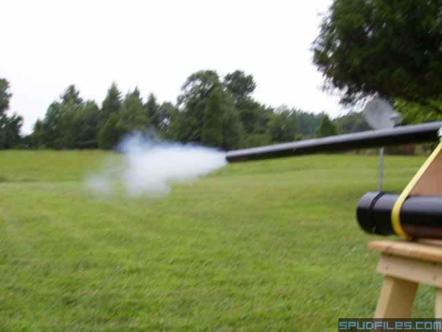

A shot of a 60 psi dry-fire.

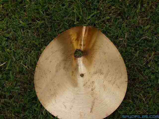

Here is an old cymbal after an encounter with a broomstick.

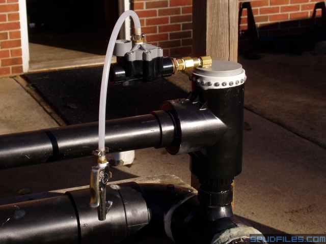

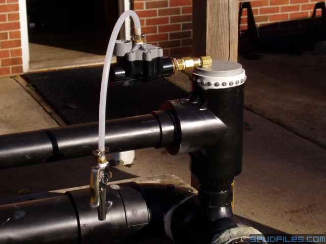

Here is the supah valve updated with the 3/4 inch sprinkler valve. It is pneumatically acutated.

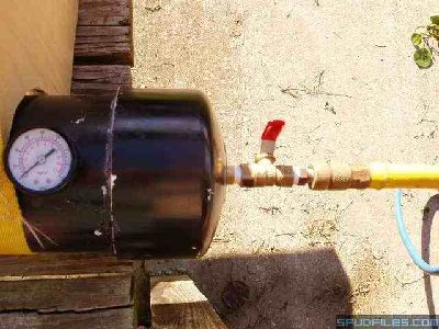

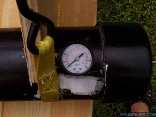

Here is the 1/4&amp;quot; fill valve and the pressure guage.
Here is the 1/4&quot; fill valve and the pressure guage.

Hey, sorry to reply so late. We made the wooden supports with some .5 inch plywood and a reciprocating saw. The template was mocked up before the end caps were put on so it was pretty easy to mock up. Thanks for the compliments. The wooden stands were made by my friends dad, a professional carpenter, and they are for sale for 20 dollars i believe.

nice cannon but 2 things can be done to improve it. one you should get something to stabilize the barrel since it has a massive length on it, and two, the psi guage should be drilled through the endcap and THEN into the body. when you put the guages and things like that on the body, you are weakening the pipe in that spot making a pressure spot and risk it exploding every time you fill it up. but other wise this thing is a beast and looks like lots of fun.
