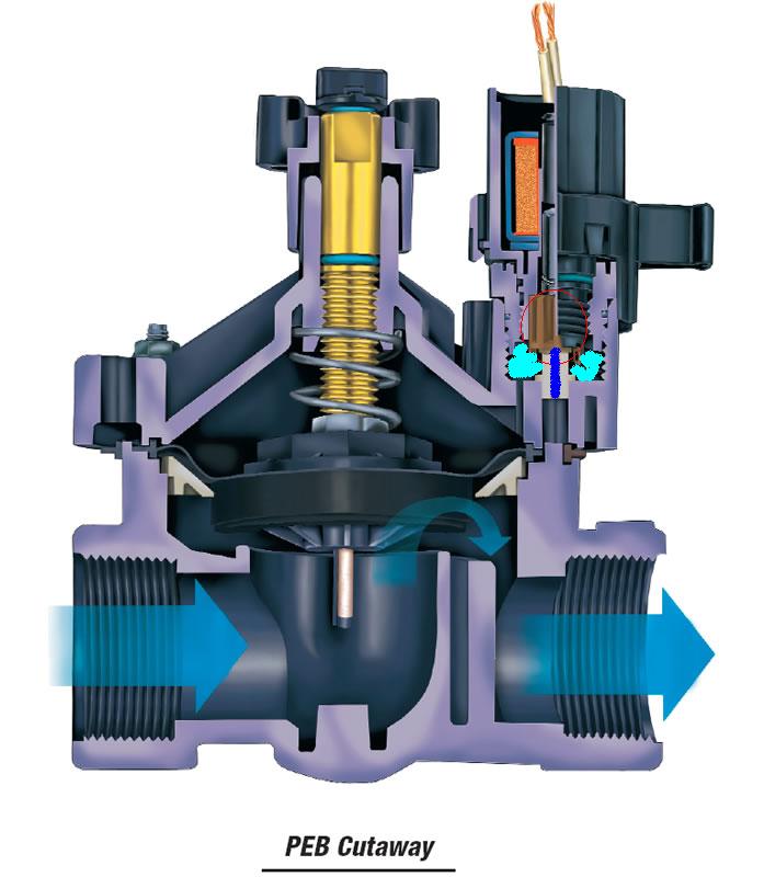

Also concerning the solenoid:
Inside the solenoid there is a metal rod, that is rubber tipped with a spring behind it. At the end of the solenoid, there is a little orange piece. When the solenoid is not powered, it blocks flow from the outer edges to the inner tube, when open, it alows flow. I was thinking, this would be good for a adjustable rate of fire gun, bb sized. The barrel would run through the chamber in a co axial fashion, with the solenoid at one end. When the chamber is pressurized, and solenoid open, air would flow from the chamber to the barrel, and with a good clip, it would be fully automatic. My main concern is the perssure capability. Confusing yes, but ile try and get some pics.
EDIT:
heres a pictoral explanation:
The circled red is the orange piece, When the solenoid is activated the air can flow from the light blue to the dark blue.
EDIT:

So i was playing around with the solonoid itself, and when i trigger it and disconnect it, the solenoid gives out a HV pulse. If you hold 1 of the solonoid connection close to the power source, the solonoid oscillates rapidly, while giving out rapid pulses of HV (ignition coil?). Is there away to recitify and have the HV pulse seperate and not pulsed back into the powersource? I want to try it with a 555, but the HV will ruin the IGBT.

The solenoid coil is an inductor and the HV pulse is typical response when its magnetic field collapses back down through the coil. You very well may feel a little (big) jolt if you are holding the wires at the time.rp181 wrote:So i was playing around with the solonoid itself, and when i trigger it and disconnect it, the solenoid gives out a HV pulse. If you hold 1 of the solonoid connection close to the power source, the solonoid oscillates rapidly, while giving out rapid pulses of HV (ignition coil?). Is there away to recitify and have the HV pulse seperate and not pulsed back into the powersource? I want to try it with a 555, but the HV will ruin the IGBT.
It's not unusual to connect a HV diode/resistor circuit across the coil in reverse polarity to shunt this nasty effect.
