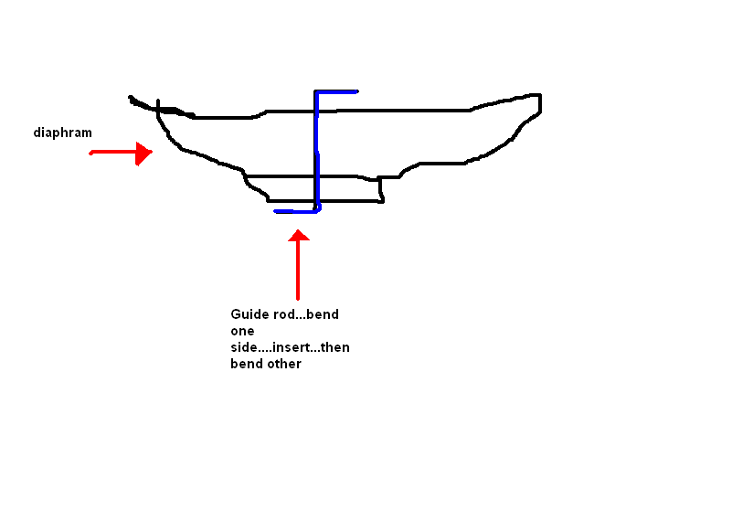

Go to bunnings and get a sprinkler valve for around $22, you won't regret it and It is extremely simply to mod (If you can drill a hole and bend a small rod then you'll be fine)
If you need any help just ask.

what do you mean bend a small rod?
the guide rod?
cos i thought you either take it our or leave it in, when would you need to bend it.

Cosmic Muffin wrote:what do you mean bend a small rod?
the guide rod?
Yes, the guide rod, with the bunnings sprinkler valves you keep the rod in, all you have to do is bend it so it stays in the right spot (its original placement is in the way of where you need to drill)
Old but extremely detailed diagram....I know, I spelt diaphragm wrong.
