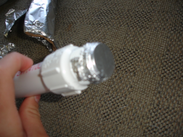

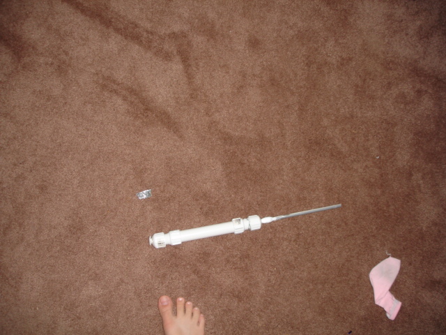

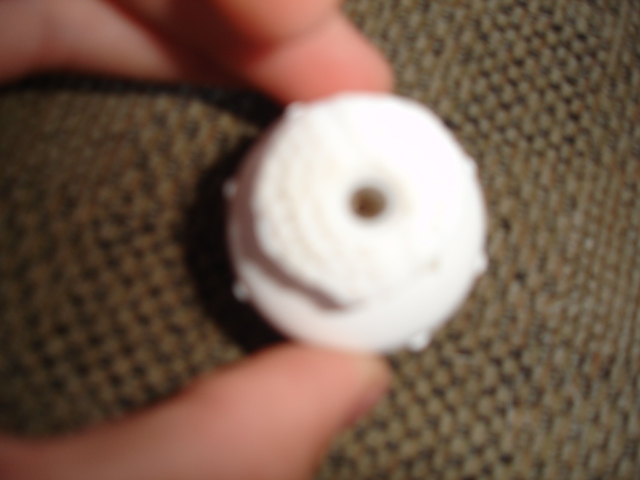

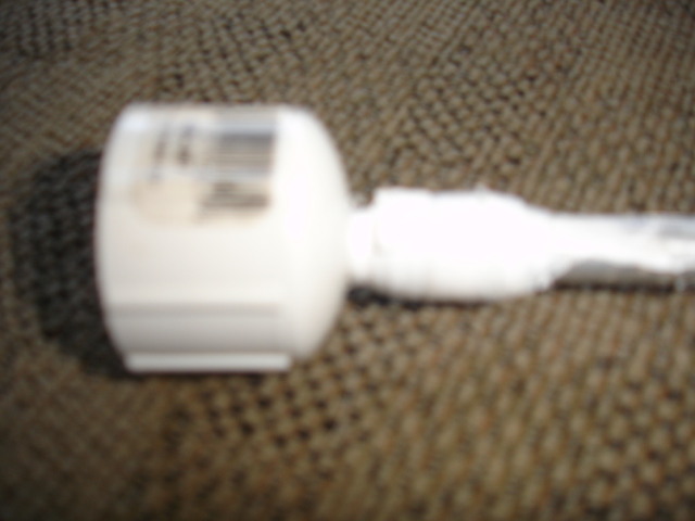

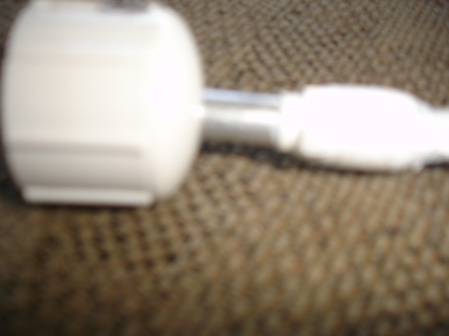

hey guys this is my first burst disk, not sure if it will work because i have no pvc glue to put it together, watch the video it explains it, basically you push the barrel down and it punctures the burst disk. :arrow:

the valve from the ball that i had laying around my house, i dont think it will work very well lol

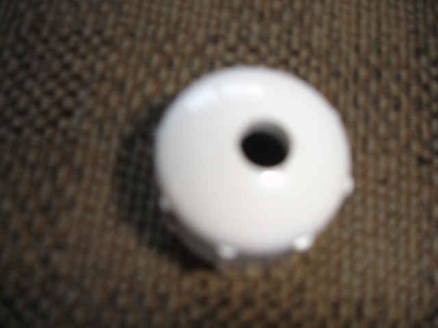

threaded end cap with hole for barrel

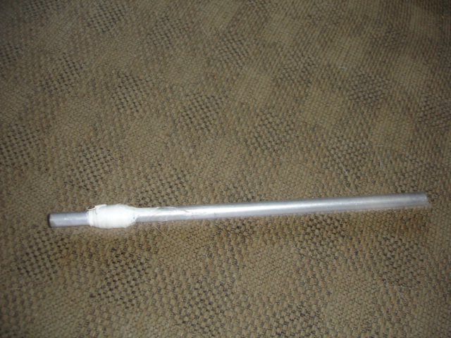

barrel
barrel
barrel before being fired
barrel after being pulled down to fire

cannon
cannon

Nice, um, foot....
Seriously, though. This will work. There have been several punctured burst disk designs, although I do not recall seeing one where the barrel does the puncturing. The biggest concern I see is the barrel flying off with the projectile when it is triggered.
As a matter of fact, Gort has put together one of the best punctured burst disks I've ever seen. It's called the Q-something.
Edit: It's called the QCTBDC - link

Also that should work fine at lower psi. Once you take it higher you risk your hand going with the barrel. What I would do is add two compression springs. A simple diagram but when you have the springs bolted in place all you'll do is pull the barrel forward a bit and then let go and it'll move back and pop the burst disk and the barrel won't fly out of place because it will be bolted down by the tension springs. 2 for 1 deal.
thats smart i have some springs lying around too, thanks

Flare the end of the barrel so that it is bigger then the hole the barrel slides in. Put an o-ring between the flared barrel and the screw on cap hole. That will keep the barrel from sliding out and should puncture the disk.

what is the best thing for a burst disk this size because, the tenfoil keeps tearing little holes in it while the cap is getting screwed on.
jmeyer1022
Posts: 200
Joined: Sun Nov 09, 2008 4:50 pm
Wed Mar 18, 2009 12:42 pm
Painters tape, then use a knife to cut the excess around it.

I'm working onto something similair, except my design will hold the barrel by itself, which reduces the risk of barrel-being-the-ammo :roll:
You could try to put some duct tape on the inside piece of the barrel (the chamber side), so that the barrel will be hold in there by itself(ofcourse this isn't really safe, and only a temporarily solution, but you get the idea)
