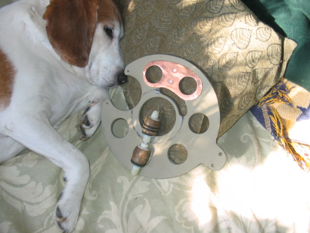

The one shown below is made from a piece of scrap plastic deck lumber made with the plug from an 1 3/8" hole saw then sanded to fit with a sander placed upside down in a vise. I put the dowel through the plug and sander spun the plug giving a smooth round shape. Total cost including the hardware was around $3.50 It's fully adjustable.
Piston and wear plate.
