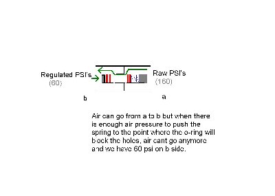

Hello all,
My current project is an bullup pcp airgun that will shoot 6 mm .42 grams bb's at 450 fps (anything higher is a firearm in canada) with at least 160 psi of air (from a bike pump)
By calculations, if the airgun is perfectly regulated, i could get 12 good shots easely, but can i regulate and release air without using two airchambers , i mean :
refill air chamber 160 psi---60psi air reg---ball valve---air chamber---piston valve
or can i simply make :
160 psi airchamber---60psi air reg---hammer valve
The goal here is to get the same fps at each shot until there is less then 60 psi in the 160 psi air chamber.
So here is my regulator, red is o-ring.
(Is there something that woul'nd make it work?)
The spring force will have to be tweaked with an air pressure indicator

well i like it and this would be perfect for me
BUT..................... i dont get it
ohspyro89
Posts: 10
Joined: Thu Sep 21, 2006 3:19 pm
Sat Dec 05, 2009 2:46 am
I don't fully understand how it works either, can you explain a little more?
The easiest way I see to do it, can be done similarly to how I understand your current drawing.
All the spring would have to do, is account for the other 100 psi that you aren't letting in.
Pressure=force/ area
Simply sum the forces on each side of the piston, to see how much extra force would be needed from the spring.
Say you have a 0.5" piston, that's 0.7854 square inches.
It'd come down to Sum of the forces in the X direction =0. We will assume there is no y or z forces and that the system is in equilibrium with the given pressures. Negative
(60 lbs /sq in)(0.7854 sq in)+( Spring Force)-(160 lbs/ sq in)(0.7854)=0
Then you can do some algebra and get this:
(60 lbs /sq in)(0.7854 sq in)-(160 lbs/ sq in)(0.7854)= -Spring Force
47.124 lbs - 125.664 lbs= -Spring Force
78.54 lbs = Spring Force
I think that's right. So you'll need a spring that can support around 75-80 pounds. You could get the adjustment just perfect by adjusting your springs output force.
It's about 3 AM, so if I am wrong, feel free to rework it! :D
Its very simple, when there is 60 psi on the regulated side, the "pushbutton " counters the spring force, closes and no more air can go , so we have 60 psi.

I don't quite understand your drawing but, I think the spring needs to be on the low pressure side.
Demon
Posts: 743
Joined: Sun Apr 13, 2008 8:46 am
Sat Dec 05, 2009 10:26 am
The theory is very simple: when there is 60 psi on regulated side, the valve shuts closed.
so that the valve closes when there is 60 psi on regulated side, the piston as to counter a spring to block the air that goes by the holes (green line)
When the piston is pushed towards the A side enough to block the holes with the o-ring, the valves shut and no more air can go to b side, so there is 60 psi.

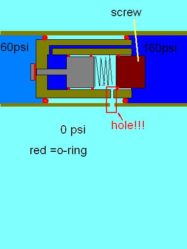

hi demon
you design is not to bad but you need a venthole between the spring site of piston and outside of chamber.
the outsidepressure is the referencepressure.
hope you understand me here a quick pic (note it is not scale, show not on the squares)
note the 0psi area in the pic

Sun Dec 06, 2009 8:55 am
Thanks a lot Jean,
But i dont think that a vent hole is nescessary, as in auridruize, there is one, but it does'nt vents with ambient air, its stays in the airchamber.How can that be possible?
I tried to contact him without success, does anyone has his email address?
How can the screw get to seal ? or else air will leak outside of the air tank.
