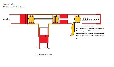

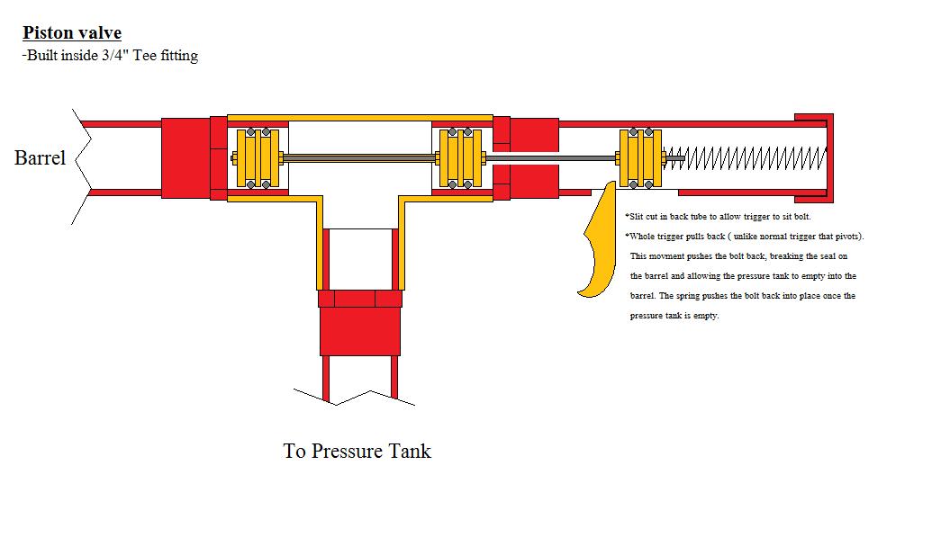

Ok... so I work nights at a hotel and have nothing better to do than sit around and design.
This gun,
http://www.spudfiles.com/forums/paca-mk ... 21703.html
inspired me to want to make a launcher with a similar QDV (I BELIEVE his valve would be a QDV... correct me if im wrong) build into a Tee fitting.
HOWEVER- as I typically share my creations with my friends (and some of them are MORONS), that trigger would end up hurting someone.
Heres a little redesign that I think might solve the problem. It separates the trigger and piston, but requires that the trigger be mounted in a wood frame with the piston access just above it.
Question- would this valve be safe @500psi?? or would the piston smash back too hard and rupture the back tube (the one with the spring in it)??
EDIT- Second question- what type of copper tubing should I be using for a pressure chamber?? (I have the copper handbook... but that shit confuses the hell outa me). Im looking for 300-400psi in a 12" long 3/4"diameter pressure chamber.
This gun,

Is that spring pulling the piston back? if not it wont work. all i see this doing over a normal barrel sealing piston valve is making it more complex and making the piston heavier.
- ThornsofTime
- Private 4
- Posts: 88
- Joined: Thu Oct 07, 2010 1:39 pm
- Location: Texas
Spring is is pushing bolt forward, sealing the valve.
trigger pushes BACK on the spring, unsealing the barrel just enough to let air pressure slam the piston back
once air pressure drops (aka the launcher fires) the spring returns the bolt to the forward position, again sealing the valve.
I think your reading "complex" because of the third head on the piston. This head really serves 2 purposes: something for the trigger to snag, and helps keep the piston centered as the first head comes out/goes into the barrel. The o-rings on the third head seem to allude to a seal of some kind but thats not the case.
The whole design is almost exactly the same as the one on the previously linked launcher. however, I replace his nuts and coper trigger with a third head thats nudged by a trigger. This solves the problem he had of his trigger slamming back once he fired the launcher and allows you to relocate the trigger almost anywhere behind the Tee fitting.

i recon its complex because a barrel sealer would be slightly more powerful(lighter piston) and much easier to make. It would probbly be smaller as well
- ThornsofTime
- Private 4
- Posts: 88
- Location: Texas
O_o how does a barrel sealer work... info or link pls. Basically im interested in any possible way to build a valve using a Tee fitting as the body.
(sorry... im still TOTALLY a pneumatic noob.)
@ilovefire- yeah probably. I would just like it to HANDLE 500psi, so that I would feel comfortable operating it at ~350psi. My plans for my next build call for a larger bore and higher psi. Probably common knowledge to everyone here... but I wouldn't have known that that would make the trigger pull harder
