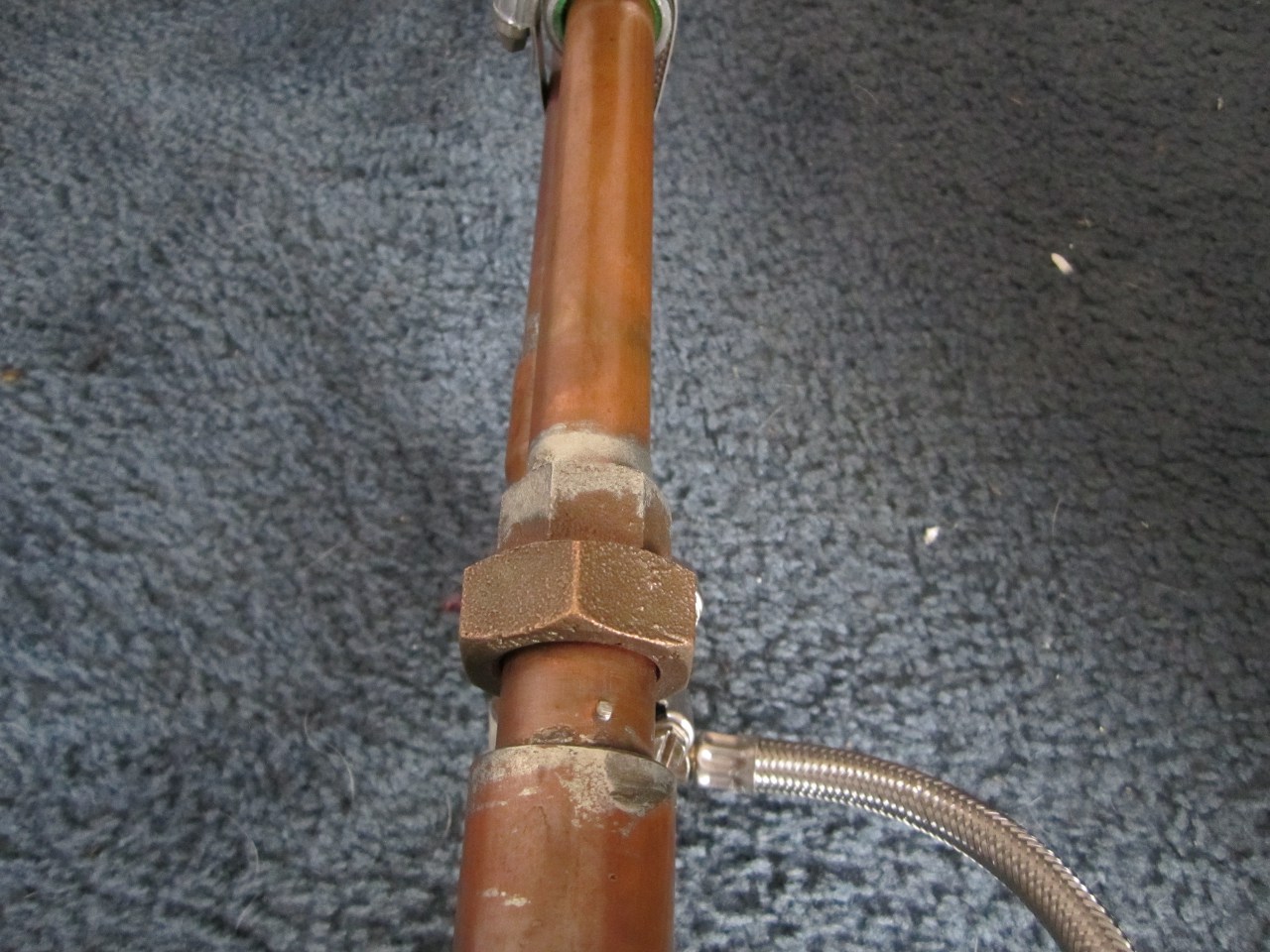

Valve Details
The valve is a 3/4" porting barrel sealing piston valve. The piston was, overall, the most tedious to assemble part of the launcher, required about a full day to get right. The first piston I built was slightly too short, which caused the piston to jam against the barrel port. After re-polishing the barrel seat, I remedied this by moving the nylon "plug" back slightly, so it would stay in the piston track.
The piston is a one-way floating o-ring type, which allows air to flow from the pilot to the chamber (when filling the pilot pressure is higher than the chamber pressure, forcing the o-ring towards the front of the piston and uncovering the equalization (blind) hole. When piloting, the pressure in the chamber is higher, forcing the o-ring towards the back of the piston, and sealing off the pilot from the chamber completely. All of this was made with standard parts (different sized washers), and the o-ring grooves simply required a couple of wraps of teflon tape to get the piston sealing in the track pipe.
Today, I got some high durometer (70A) rubber for the sealing face, and I haven't had a single leak since.
This valve will pilot with a schrader valve, which is eventually one of the reasons I switched to an auto plug and check valve for filling.
Here lies a dead YouTube video
The pilot has changed a lot as well. It originally was a blowgun, but I swapped this out with a simple 1/4" ball valve mounted in a trigger's normal location. The hosing from the piston valve to the pilot valve originally was 1/4" OD copper tubing, but this turned out to inhibit my servicing the piston. I picked up a 12" length of braided stainless hose with 1/4" compression fittings at the ends, which allow for quick and reliable connections and disconnection.
Filling is accomplished through a male auto plug and a check valve.
