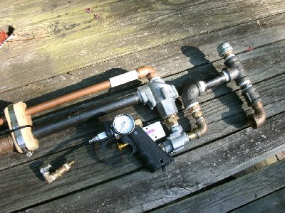

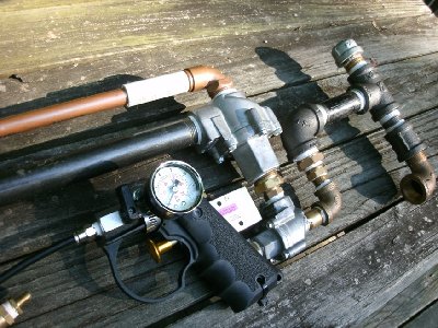

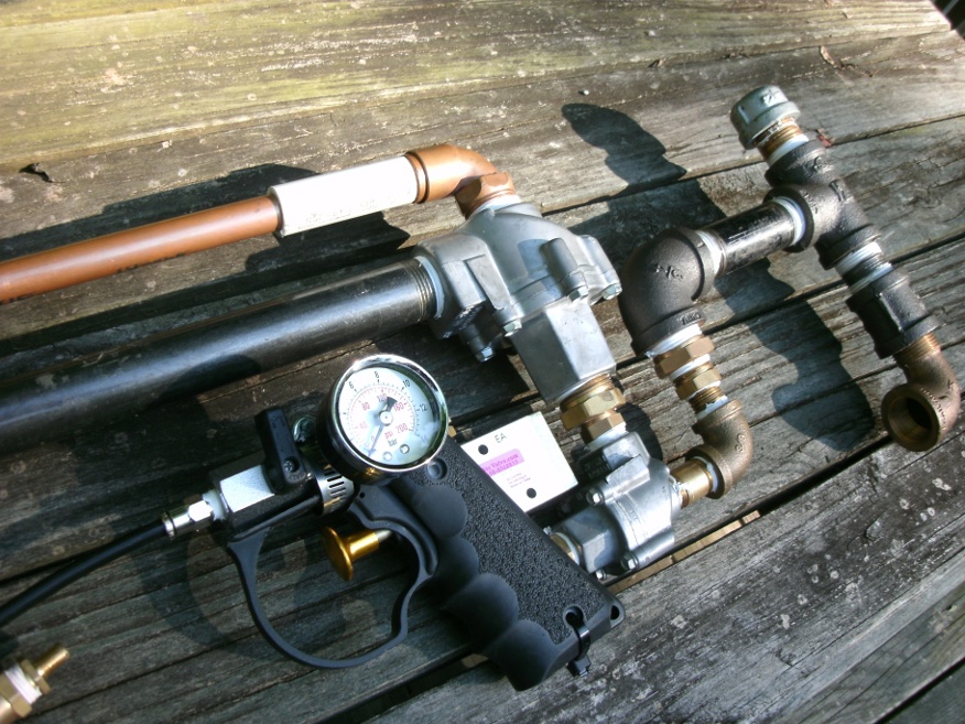

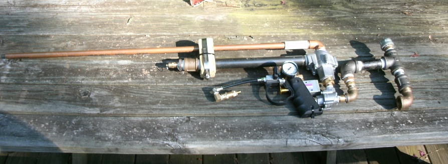

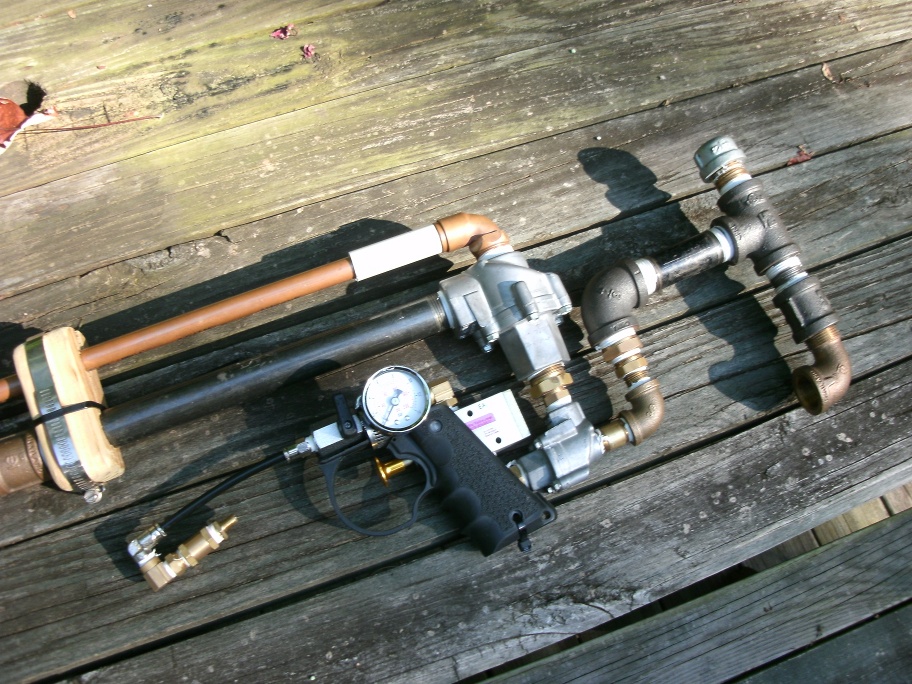

Here's a cannon I've been tinkering with for a while. It uses not one, but two QEVs, so I've dubbed it the CQEV (Cascading QEV) cannon. It's probably not the most efficient use of two QEVs but I've been accumulating parts for a while now and had them lying around. Here the specs
Main Valve: 3/4" Deltrol QEV
Secondary valve(s): 1/4" Deltrol QEV & 3-way push button valve
Barrel: 1/2" Copper (pictured), interchangeable with 1/2" or 3/4" PVC barrel (not sure of the lengths exactly)
Ammo: marbles, AA batteries, empty co2 cartridges... anything that fits
Extras: secondary exhaust noise dampener (also functions as a stock), breech-loading, paintball gun grip, barrel support, safety-valve
The "secondary exhaust noise dampener" is just the extra piping attached to the exhaust of the smaller qev. The longest 3/4" pipe section is filled with some steel wool and a home made baffle (some rubber disks with spacers on a threaded rod) and it reduces the extra noise from the secondary exhaust a noticeable amount.
Typical operating pressure is around 100 psi. I have a 115psi pop-off relief valve on it right now so I can't take it any higher than that. I plan to replace it with an adjustable pop-off in the future. You can't see the 3-way DCV very well in the pictures because of the grip but I know some of you are familiar with this type of valve. It's rated for 115 psi but I know other have used it at higher pressures. Anybody have any idea what kinds of pressure these DCVs can handle (or what the potential risks are operating them at higher pressures)?
The DCV allows bolt-action-ish potential with a constant air source (all I have is a bike pump right now), or even semi-auto if I make a reloading mechanism. I'd like to try for semi-auto, I have a double-acting air cylinder I think I can manage something with, but there're lots of kinks to work out still.

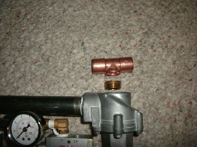

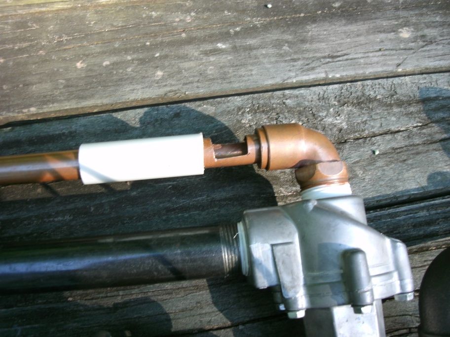

I'd like to get the barrel closer to the chamber, but I haven't found a way to make it more compact than what I have now (threaded bushing with a chopped down elbow epoxied in). The threads seem to take up a lot of space no matter what. I wish I could just chop the threads in half but that doesn't work with tapered threads.
I have used some elbow that didn't have the hexagonal part. I did notice there was a lot of unused thread throughout the build. Can you not get hold of some parallel pipe fittings ?
If not could you not enlarge the ID of the fitting enough to poke the elbow all the way down (or use an elbow a size under) and cut off the top part of the fitting. As long as the elbow is securely glued in it should be fine use.

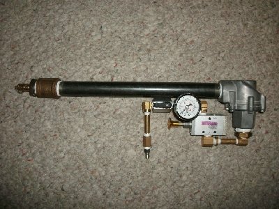

Took some advice and ditched the second QEV, now I suppose I'll have to think of a new name
Performance seems comparable (don't really know, haven't done any quantitative tests) although the speed at wich the trigger (DCV) is operated now has a relatively drastic effect on the power of the shot, whereas before it didn't matter how slow you pulled it you'd always get a pretty consistent shot. Not really an issue as long as you remember to make a quick pull.
I originally tried connecting the DCV to the QEV with some hose (first braided then push-to-connect) but wasn't able to get enough flow through either for the DCV to pilot the QEV, so I went with some 1/8" brass fittings which worked out pretty well.
Significantly more compact and lost a lot of weight without the incessantly heavy stock.:thumbup:
I also ditched the grip and intend to make wooden frame/grip/stock. Hopefully I can make it look pretty (anybody know any good guides on shaping your own wooden stock? I think I've seen one on here somewhere)

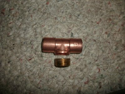

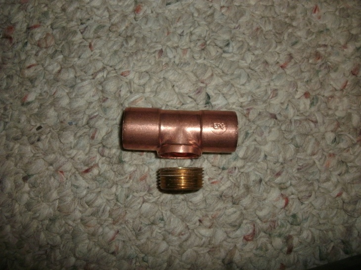

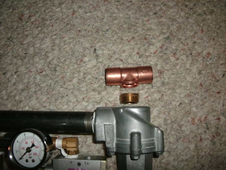

I'm also working on modifying a copper tee for the barrel/breech that will be more compact than the elbow I have now and also be a step in the bullpup semi-auto direction.
**Added pictures
