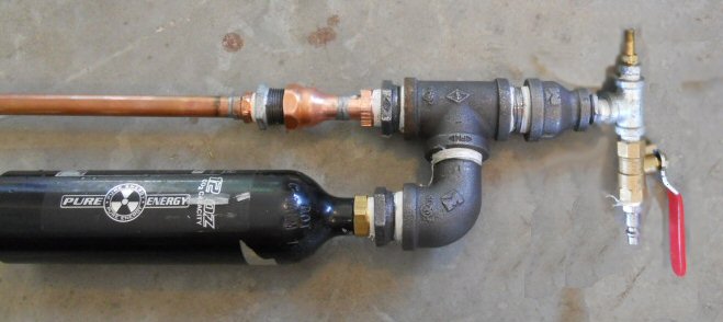

I have spent the last few weeks building and troubleshooting my new cannon. It is a full metal pneumatic with a 1" tee housing the piston made from a bolt and rubber washers. It has a 1/2" copper barrel and shoots AA batteries and shotgun shot, amongst other things.

Here's a rundown on the new gun

I asked around and one of my good friends got me a couple old co2 tanks that were too old to be refilled. We used a torch and some effort to get the regulators off. One simple piece at the hardware store got the 12oz tank on to the gun. (20oz in the future!)
I got these tanks to replace the pvc chamber I had so I can go up in psi. :)
I drilled out the adapter because it seemed a little restrictive
after:
12oz tank with new fitting on left, 9oz tank with loose reg on right
The new, somewhat pricey, sealing face (2nd time I've soldered pipe)
And the piston
BALL VALVE will be replaced with a CHECK VALVE soon because it is very dangerous.

Nicely done and especially nicely presented, love the luxurious switch :D It looks like it will take a lot more than 200 psi, definitely you can take it to 450 psi before the blowgun starts to leak :) beware the noise though!
Let's see some videos :)
You might want to consider piloting with the ball valve to go to higher pressures, it will reduce pilot volume too:
