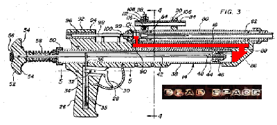

Before I begin, this cannon was inspired by this. Seeing as it is a very rare antique,
I thought instead of hunting for one, it would be more practical to build one.

With a name like that, I was assuming it would be based on this...

LeMaudit wrote:now why am I so intrigued by ghetto looking stuff suddenly....
:shock:
Also.

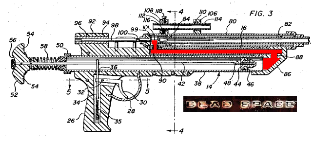

And I'm even more intrigued by this inspiration you had, this old gun is pretty weird...
Pretty inefficient too:
