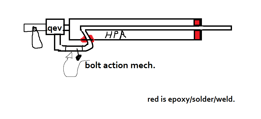

Bolt action co-ax IDEA
farmerboy32
Posts: 28
Joined: Thu Jan 01, 2009 2:43 pm
Tue Jul 26, 2011 5:15 pm
this is a idea i had while day-dreaming at work the other day haha.
leave any questions or comments below and i will address them as best as i can.
bolt action co-ax.png (16.92 KiB) Viewed 2861 times

The bolt action must be in-line with the barrel. Coaxial and bolt action dont really get along well. For bolt action, I suggest an over-under or inline gun.

@Mr.Tallahassee, i was thinking it would be able to shoot ball bearings, bb's , etc. so the pipe would just need to be bent,and not 90 degree elbows.

That diagram doesn't really make sense...
Tue Jul 26, 2011 8:16 pm
lol... you're right

A gravity feed magazine and an o-ring detent would work better with the bolt action. You could drill a hole and use a pressure rated snap tee with a hollow, o-ring sealed bolt. Now that I notice it, that diagram doesn't make sense.

The QEV exhausts the atmospheric barrel pressure into the chamber through a breech load :toothy10:

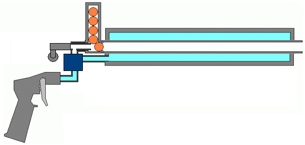

Or perhaps, if a blow gun were connected correctly, it would actually work. It would just have horrible flow. Give me five minutes with paint. :wink:

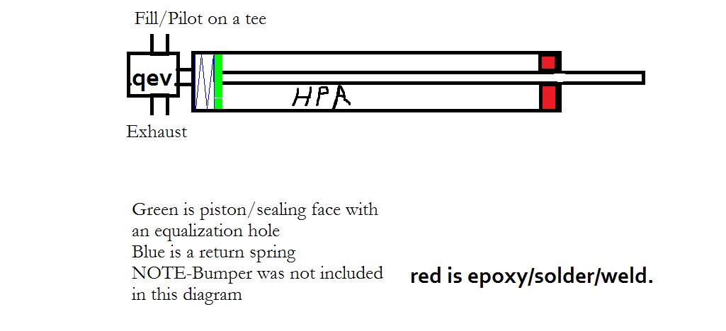

Tue Jul 26, 2011 10:59 pm
Gun Freak wrote:That diagram doesn't really make sense...
Maybe it's a bit like this but with the curve on the other end ;)
Though it actually does make sense if the QEV is properly configured, the ball valve pilot needs to be at 90º
Here's a more plausible configuration:
