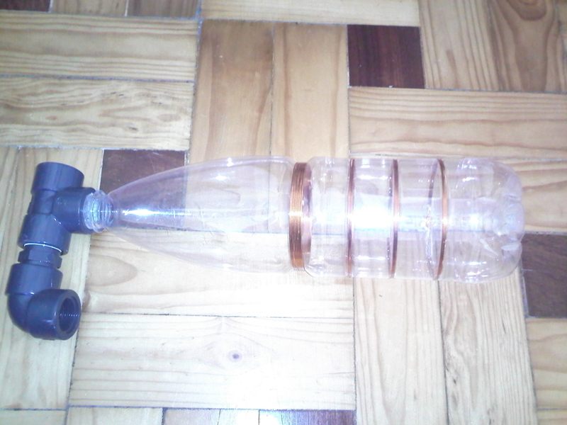

Hum I never thought about reinforce bottles with fiberglass
looks good, but you could use some tape for that too like those bottle airguns on youtube, and much cheaper than fiberglass
You can actually get small sections of fiberglass cloth for surprisingly low cost, you just have to look.wyz2285 wrote:Hum I never thought about reinforce bottles with fiberglass![]()
looks good, but you could use some tape for that too like those bottle airguns on youtube, and much cheaper than fiberglass![]()
I did mention that there is fiberglass strapping tape, and that it's easier to buy and use. It's just not as strong.
Something else I just thought of: AirCommandRockets only tested 2 layers of fiberglass, and that got them to 300PSI. If used in air tank applications rather than rockets, one could increase the layers more for even higher pressure.

aEx155 wrote:Something else I just thought of: AirCommandRockets only tested 2 layers of fiberglass, and that got them to 300PSI. If used in air tank applications rather than rockets, one could increase the layers more for even higher pressure.
