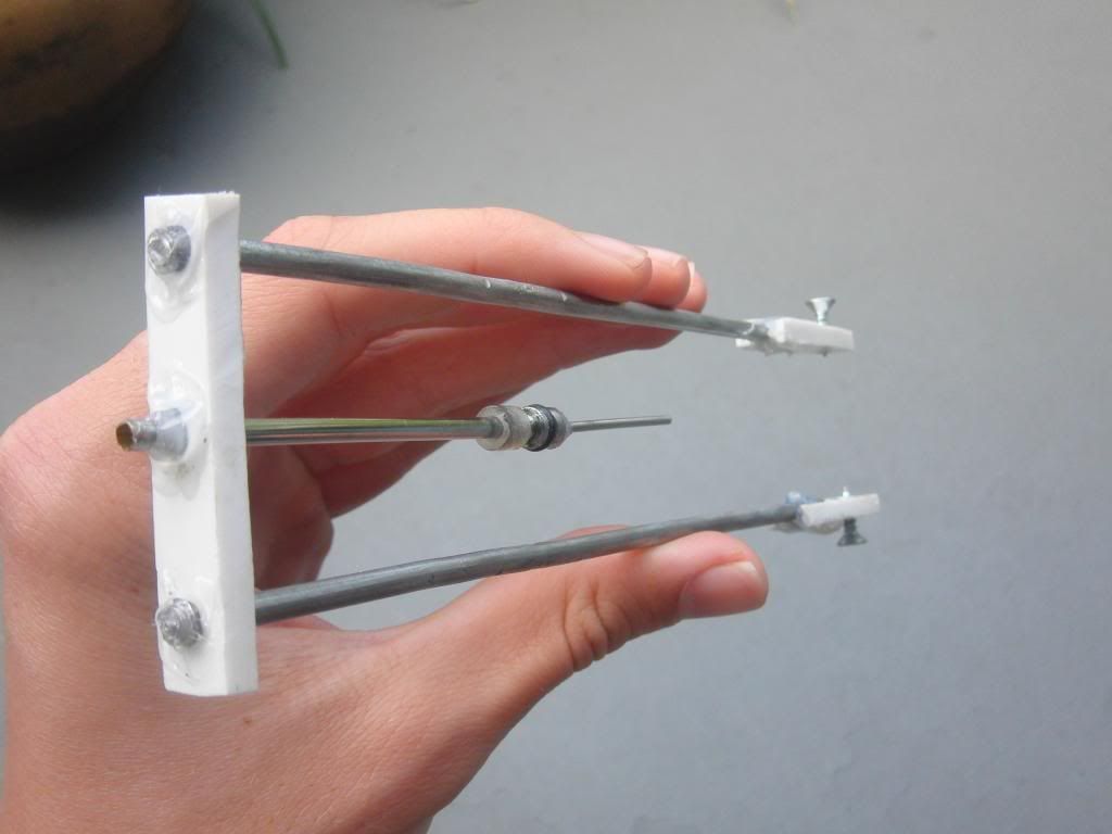

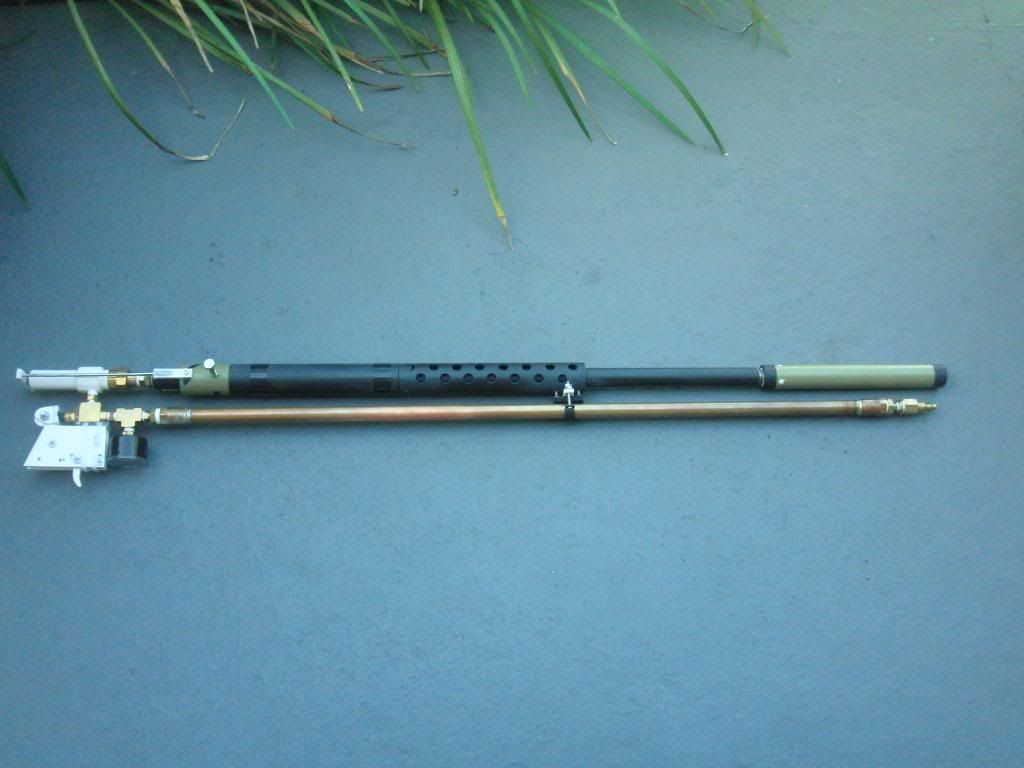

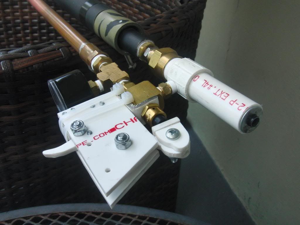

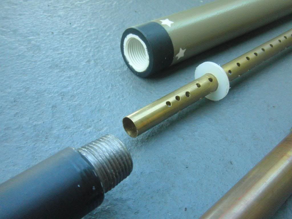

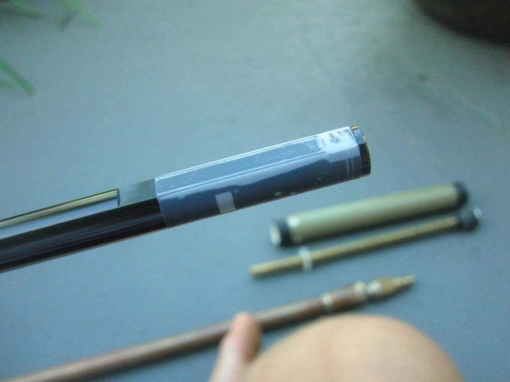

I'm back! I haven't bee active in quite a while. Here's my latest project, both a continuation of my hammer valve project and a final resting place for my valveless airsoft gun that never saw the end of development.
Here's the full video.
It's already been modified since I uploaded the video. I've gone back to the trigger mechanism that's in this video:
Here are some pics, taken after modifcations since that video.
Assembled-
Disassembled-
Rear assembly-
Bolt Action unit-
Plunger and Connection Arms-
Barrel shroud/Chamber union support-
Hop up-
Breech-
Silencer disassembled-
Silencer connection-

The power level is excellent for airsoft, probably some where around 400-500 fps.
I guess the tight bore barrel really saved the air efficiency and the low volume of output air plus suppressor made it pretty quiet.

@LnL:
I couldn't help but think about how similar this gun looks to some of your past creations while I was building it :D The flare gun trigger is very strong. only problem is the tip of it is steel and pointy so it either needs to be modified (which would be difficult) or the valve needs some serious fortification. The tip doesn't come very far out of the metal so you should take that metal cover off. For unregged CO2 I would assume it would do OK.
@Blitz and wyz:
The tightbore barrel makes all the difference! Not only with the power, but also the accuracy. Without a hop up, this gun has the accuracy of a low end airsoft sniper rifle. With my hop up that I can make use of now with the breech load, the accuracy is a little better.
Yes, the silencer makes a huge difference. Most noticeable in person though. A safety isn't really necessary, as I don't pull back the hammer until I'm ready to fire.

Using an airsoft barrel was a good idea, I might have to give that a go at some point too.
When I thought that was my only way out a friend show me a metal store and they sell perfectly straight 6mm ID 12mm OD brass tubes :twisted:
