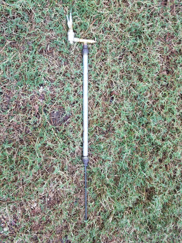

This is the second coaxial gun I've made, and this one is all metal except for a couple of jb epoxy welds.
The barrel is 1/4 steel brake line bought from an auto parts store, which is the perfect diameter for BB's. The body and chamber is 1/2 inch steel pipe. I used two rubber stoppers glued together for the piston which fits perfectly in the pipe. Originally I exhausted and filled from a 1/4 inch ball valve, but I had this qev around not doing anything so I added that as my exhaust valve. For ammo I'm using bbs and some homemade darts out of qtips and the ends of nails tapped together. I strapped the gun yo an old crutch for a stock and it works quite well
Here's some pics:
It's fairly accurate. At 40 feet here's the grouping:
Definitely impressive given the context!
1/4" steel bearings would probably give even better accuracy and should be relatively cheap to obtain.

jackssmirkingrevenge wrote:It's fairly accurate. At 40 feet here's the grouping
Well I think it's quarter inch outer diameter, which, in this case gives the barrel an inner diamter thats just a bit larger than .177 cal. 5/8s brake line fits those quarter inch ball bearings a lot better if I remember correctly, but I may be completely wrong.
And yeah, I originally exhausted with only the quarter inch ball valve, but I just slapped the qev on for giggles and like has been said there's not any gained performance. I just like it
If I want higher pressure though, I do have a shock pump and use that as a boost after filling it to 100 psi with my compressor. So far I've only gone up to around 250 psi and noticed a huge boost in power from the shots without the shock pump. Pressure really is the key like JSR has said.
Ah, I thought you were referring to the ID.
