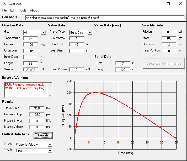

I am trying to use the GGDT software but im having issues. I keep getting an error stating that the projectile never cleared the barrel, but I believe I put in reasonable numbers.
The odd thing is if I increase the chamber inner diameter, it decreases the volume. If I increase the outer diameter, it increases the volume. I don't know why the outer diameter is even relevant to the experiment since its just the wall thickness.

"Outer Diam" is the inner diameter of your chamber tube.
"Inner Diam" is the outer diameter of your barrel for a coaxial cannon.
If your design is not a coaxial, the "Inner Diam" should be zero.

Man how were we supposed to know that. Anyway I'm starting to get realistic numbers now. Thanks!
