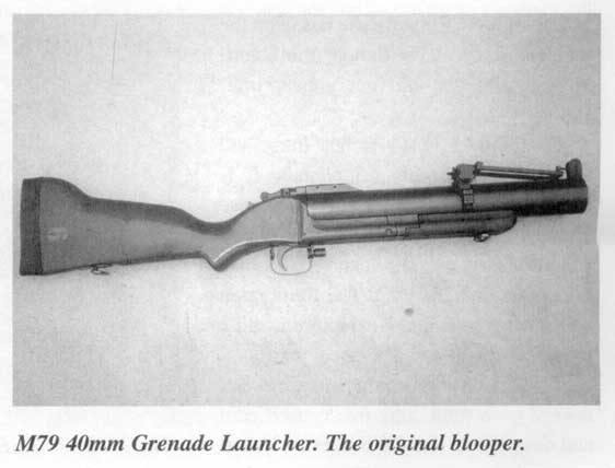

that is a awsom gun i rely rely like it and with the stock upside down it looks like one of these greanade lanchers nice gun :D
