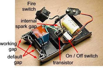

When you say it doesn't work do you mean when wired to the spark gap in a gun or when operated in the way the stungun was designed?
Try using a smaller spark gap and see if it'll spark right away. Just attach a short piece of wire to one of the electrodes.
Stunguns aren't exactly precision instruments. What do you expect for less than $20? (Want to bet that the stunguns police use cost a heck of a lot more than $20 each?) They do crap out. They do loose the ability to spark the default gap, though they will often still spark across a smaller gap. They do fail completely.
They are not designed to be operated for more than 1 or 2 seconds out of several tens of seconds. Repeated firing, especially running'm for more than a second or so, will kill most cheap stunguns pretty quickly.
Wangpushups report of a "warm-up" period is the first example I've every heard of this failure mode.
Offhand, I would guess that it is not a capacitor or a main power transistor problem since both those components are usually pretty much either OK or completely dead. The problem may be that the internal trigger gap has been used so much that it is pitted and burned. That opens up the trigger gap and requires a higher voltage on the cap before it fires. It takes the charging circuit a while to get the main cap to a high enough voltage to arc across the trigger gap.

Don't most stun guns use an internal spark gap as a switch to dump the ~300V in the primary cap into the second step-up transformer?singularity wrote:well there should be 3 basic parts to a stungun the primary coil, the secondary coil, and the switch. the switch creates a high frequency oscillating wave. the wave oscillates the the 9v from the battery which is fed into the primary coil, this coil bring the voltage up to around 300v. then there must a second switch which oscillates the 300v and puts it through what appears to be a iron cored coil (ie a mini ignition coil) this could easily generate tens of thousands of volts. if there were a capacitor it would be a filter cap to clean up the voltage coming from battery. it would not take more than a fraction a a second to fill. on top of that it would be very unlikely that it failed at 9V.
The internal spark gap usually looks like a pair of metal strips in an x-pattern with a very small gap between them.
The first stage of the stungun steps the voltage up to a couple hundred volts and stores that energy in the cap. When the voltage is high enough the internal gap sparks and the cap is discharged through the second step-up transformer creating the high voltage spark at the working electrodes.
Very small changes in the spacing of the internal gap will make the stungun not function correctly.[/img]

Yes, mine jumps a arc on the inside rite at the +. I don't know if thats wangpushups problem.jimmy101 wrote:Don't most stun guns use an internal spark gap as a switch to dump the ~300V in the primary cap into the second step-up transformer?singularity wrote:well there should be 3 basic parts to a stungun the primary coil, the secondary coil, and the switch. the switch creates a high frequency oscillating wave. the wave oscillates the the 9v from the battery which is fed into the primary coil, this coil bring the voltage up to around 300v. then there must a second switch which oscillates the 300v and puts it through what appears to be a iron cored coil (ie a mini ignition coil) this could easily generate tens of thousands of volts. if there were a capacitor it would be a filter cap to clean up the voltage coming from battery. it would not take more than a fraction a a second to fill. on top of that it would be very unlikely that it failed at 9V.
