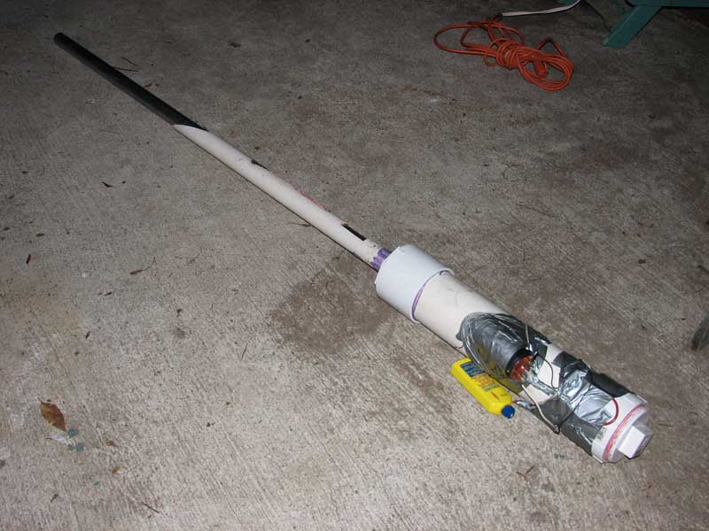

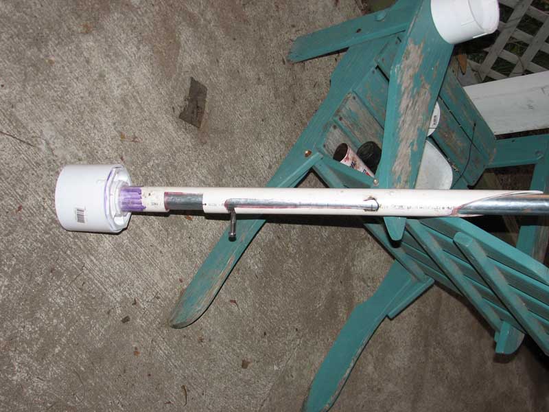

this is my first gun, i wanted breech loading and bolt action. i used a car ignition coil for the spark, so i get a really really hot spark from it. i havent yet shot potatoes from it because i finished it fairly late and even when just shooting a wad of fabric it sounded liek a gunshot. i use lighter fluid as the fuel. im hoping to convert to a propane/ propane oxy setup next.

nice, i dont like the duct tape tho. :D

tested it today. and it kicks, works really well with little pre cut potato bullets. theres very little to no leakeage in the bolt action. with some work im hoping to get to 6 rounds a minute. maybe with a clip or something. car ignition coil also is very very good sparks.

Wow this seems impressive as far as it's functionality goes! What did you use for the bolt handle? With enough spoofing up it could look really nice too.

2 reply, one the bolt handle is just that a bolt welded onto the metal barrel.
