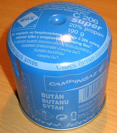

4) I'm not too sure what fitting/connection the butane cannister has, can anyone point me in the right direction?
Thanks for all the help. I hope this cannon will be a success.
The butane cannister.

You can get a cheap blowtorch or camping stove that the cannister fits into, it needs a container as the top has to be pierced for the gas to be available. I use one such blowtorch to fill a syringe which is then emptied into the chamber.

It looks like a propane canister used for portable bunsen burners to me. Just a note on them, never puncture a hole in a loaded one. They fly around like rockets and hurt a lot.
As for the pipe, it sounds like either thinwall or electrical conduit. Neither is very good, and it would be extremely dangerous in cold weather. Also, the thinwall stuff I have around is brittle so you're asking for shrapnel. I wouldn't risk it, just go to your hardware store and buy a length of high pressure rated, thicker walled schedule pipe.
As for a fitting for the canister, it's definitely from a bunsen burner. Maybe a chemsit/scientific sort of place may be some help with that. You probably want it to end up with a BSB fitting, as that's quite common.

What the heck is in that fuel cartridge? The top says "20% propan" (propane?) the side says "Butan" (butane?).
http://www.outdoorfair.de/epages/611918 ... lags167900
An injection cartridge with 70/30 butane/propane mixture. For the Campingaz 206 series. To date more than 900 million sold. 190 g.
So, it appears to be a mixture of propane and butane. The proper fuel ratio would be about [(3.23%)(70) + (4%)(30)]/100 = 3.46% if the cylinder contains 30% propane and the rest butane.

The cylinder I'm using is pure butane. (The pic is a bit inaccurate, the cylinder I have is different.)

3)Work out way to attach fuel cannister.
