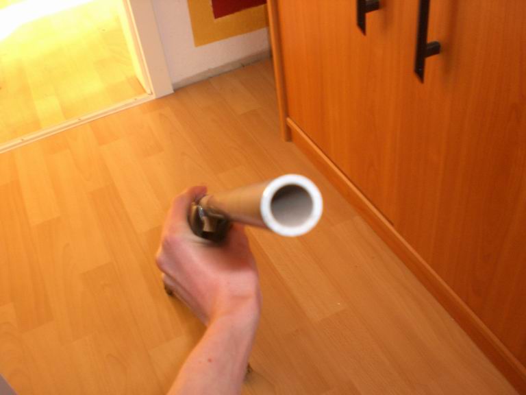

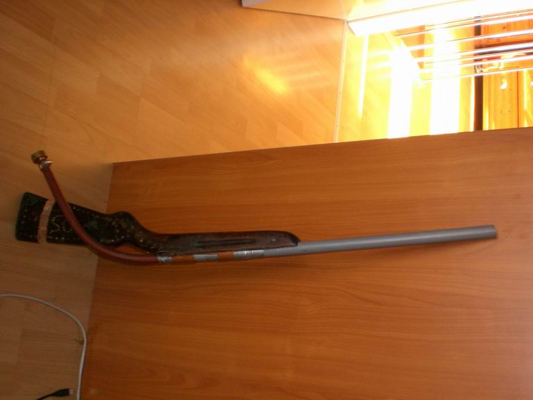

Hey there spudders,
I actually wanted to build a mini just for fun because I was bored
But it turned out a little bigger. So I gathered some stuff laying around and began to build this little spray & pray sniper. I have shot with it a few times already so it works
Specs:
Barrel - 15mm/ 42cm
Chamber - 250 ml

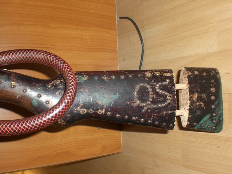

Stock - old woodn toy (modified a bit)
I think the pics will tell the rest!

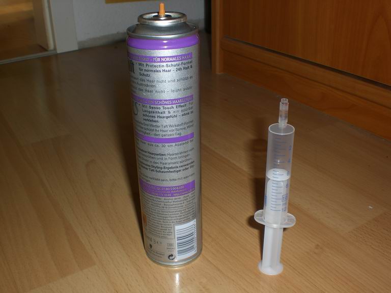

I do have a question about the fueling. If I´m right with this:
The Chamber has ~250ml so I have to add gas of ~10ml = 4%?
Is this okay?
Tell me if you´d change anything

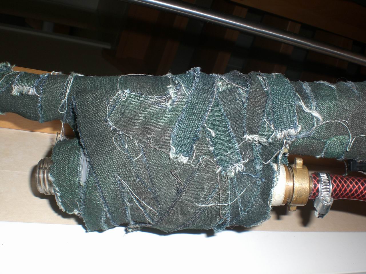

Edit:
-I put some kind of guilly around it
-Added the piezo
-shortened the hose as much as possible!
+ I screwed it to the barrel
_____________________________________
Another Edit
-took off the hose thing
-replaced it with 2x 90° copper pipes
-Softair Reddot
-Laserpointer (just for looks) 8)
I´d like to thank starman. You were right the hose thing was a bad idea. It works much better now. Thx

That rubber hose is rather dead spacey and long and soft and crooked so I believe it's going to eat up some of your performance. Also, I'm not sure I would want to shoot that thing with my eye and face so close to it....that hose only looks butt-spliced taped to the barrel....
Looks like you are using butane fuel so 4% should be about right. With propane you would want to push that up to 4.2-4.3%, with MAPP 4.8-5.0% or so.

okay thanks about the fueling answer.
yeah its not fixed properly but i didn´t shoulder fire it yet,
just put it in the vise and fired it.
I´m going to try and see if I´d get more peformance with a brustdisk
between the chamber connection and the gardenhose.

Butane should be at 3.2% with air, so 4% is too much and will hit performance slightly.starman wrote:Looks like you are using butane fuel so 4% should be about right.
It has been shown that a slightly rich mix from theoretically perfect actually provides a small bump in performance before falling off, thus all my numbers were bumped up a bit purposely. 4 is slightly higher than optimum but I would certainly be willing to guarantee the shot if everything else is in place.Ragnarok wrote:Butane should be at 3.2% with air, so 4% is too much and will hit performance slightly.starman wrote:Looks like you are using butane fuel so 4% should be about right.
Slightly rich - 4% is a full quarter over ideal. I'd be aiming for 3.5% perhaps, but not 4%.starman wrote:It has been shown that a slightly rich mix from theoretically perfect

4%, the extra may be burnt in that hose. It will be hurting performance, try shorten it as much as possible. And dang at the chamber..I was worried about using DWV (non-pw) in a mini before... ( )

No doubt, the hose IS acting like part of chamber in this configuration.inonickname wrote:4%, the extra may be burnt in that hose.
