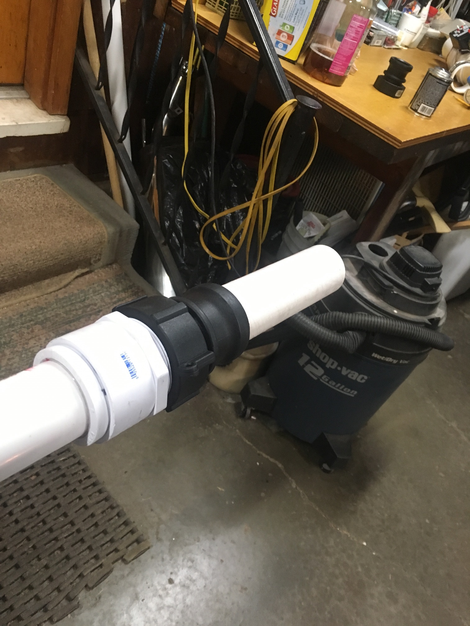

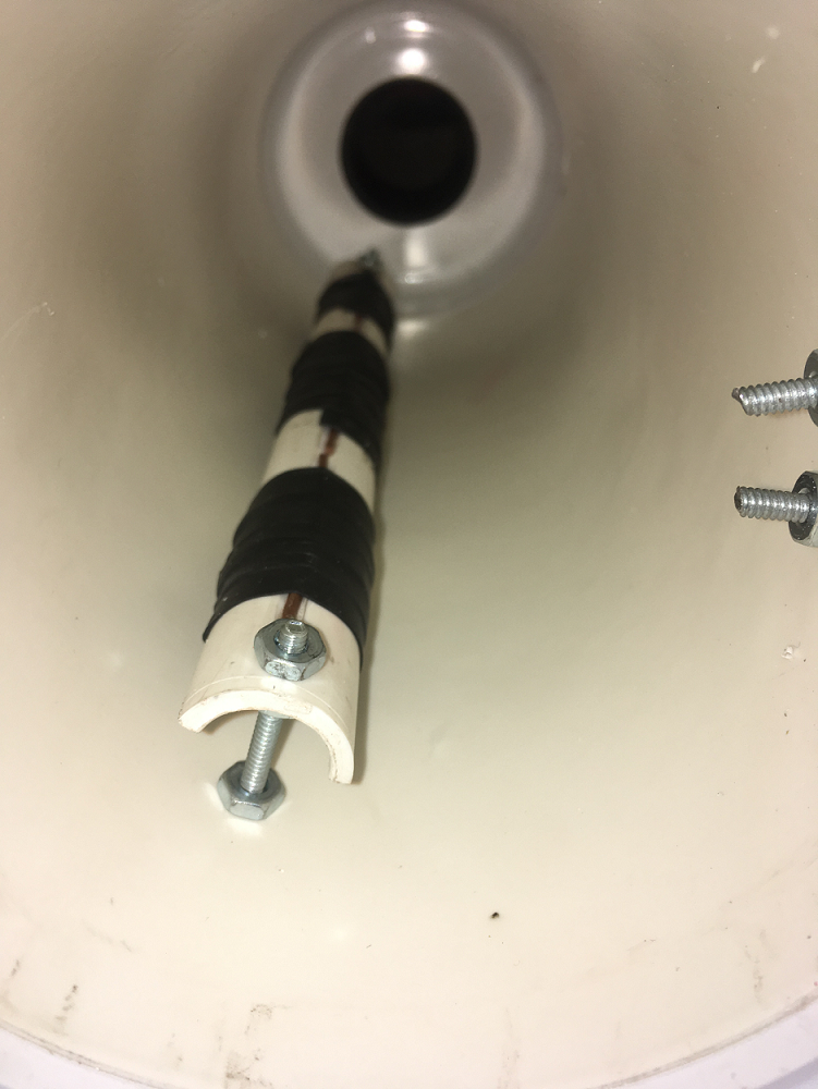

Thanks Mark. I figured a linear 7812 would work but was hoping I could just run strait 18V in short bursts. Attached are some more detailed shots of the chamber. I give the cleanliness credit to the new to me Oatey Fusion. I was a little apprehensive about an all in one but the spec sheet was identical to regular medium cement so I figured I would give it a shot. I will post some more pictures of the pass-through barrel once I cut the double bevel on it tomorrow. If any one has any specific questions feel free to ask! I am hoping this build will encourage others to continue spudding as well.

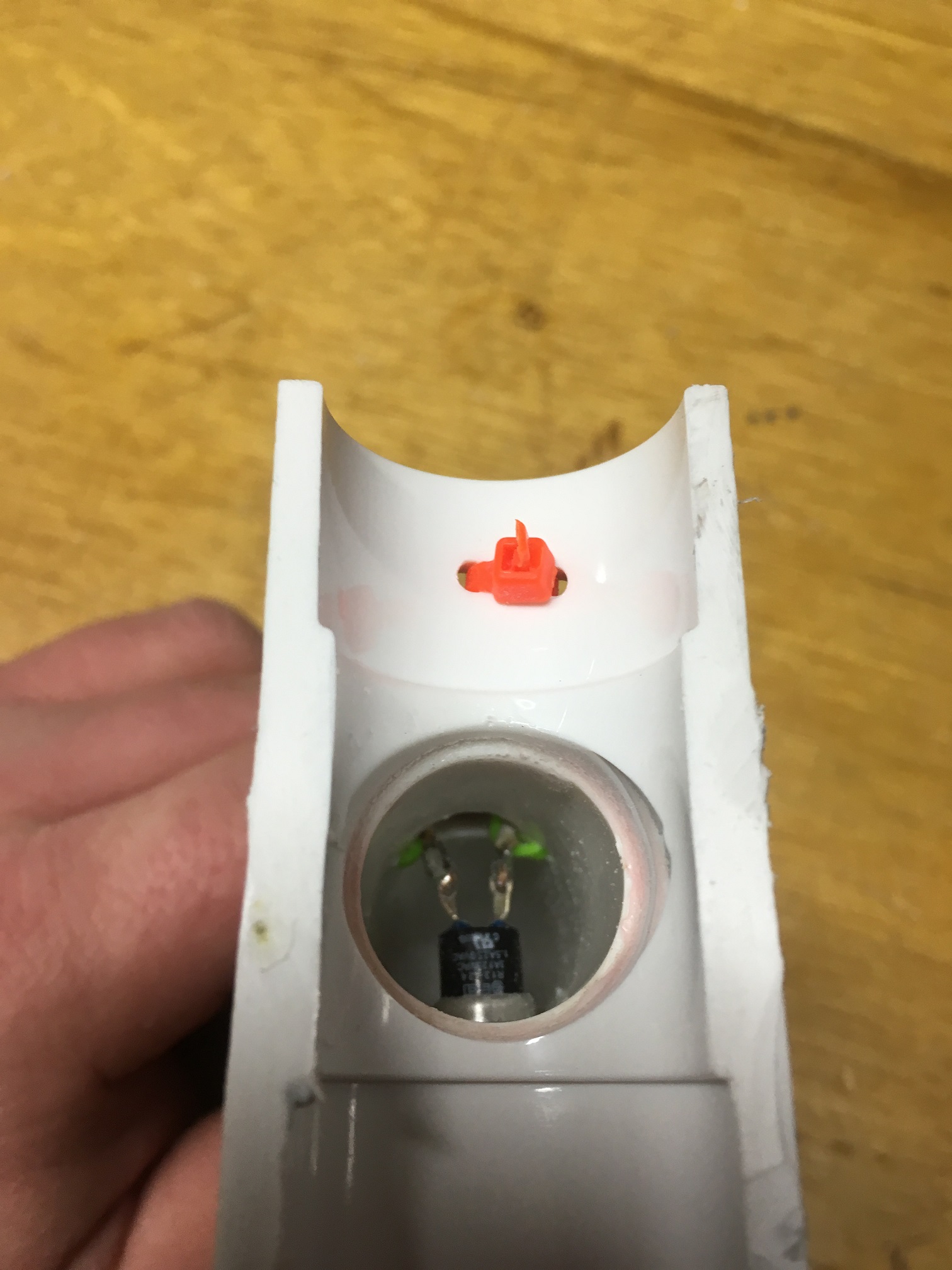

Got to do a little more work on the cannon today. Pictures show the fittings and double beveled pass through barrel. The PVC fittings only took 15 minutes to sand out but the black camlock took over an hour and a half. I also switched the camlock on the chamber to come through a SCH80 close nipple which allows the barrel to pass through good and snug. Working on a latke style trigger as well.
