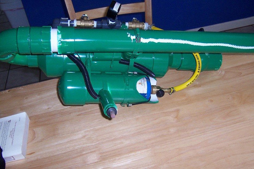

Here is my first propane injected gun.
I used double valves and a guage so that I could meter my propane shot. The chamber is 4"x14", and is done in sch 40 and sch 80.
I used a 2" ball valve to vent the chamber, and have a built in bottle holder on the other side.
The barrel is 2"x5' and is threaded for quick change. (I am working on a golf ball barrel next)
I used a partial piece of 2" PVC instead of a project box so that it would "fit" better with the overall look of the gun.
My fan is powered by a 9 volt battery, and I am still using a grill ignitor, but have a stun gun on order.
You probably notice influence from several other guns posted here on the forums, and I would like to say thanks to all of those guys for their great designs. Most notably Gort's blue flame, Keith's ECL 1400, and whoever "invented" the serrated barrel end.
The metered propane definitely adds to cost! (this gun is ran somewhere in the $150 range)
The serrated end and ports work great on the barrel, and look good too!
I preffered having a holder for my tank that allowed me to remove it quickly. I did bungie cord it in place so it couldn't slide out.
My trigger is in the right handle, which I will redesign when I go to the stun gun.
My propane hose is 200psi rated compressor hose. (I liked the yellow)
My spud chucker... Notice the fan switch in the left handle and the wire looms to clean up the overall look.

Oh nice man! I'm really happy to see other people using this design. I hope it's working out well for you. I know I love it. :P

The weather's been pretty nasty, and work has kept me from doing but a few firings, but I know that I put my first spud into the woods across just under 7 acres. I will addd to the post with some more specs once I get some better weather. Right now I'm just set up for taters and "shotgun" ammo (anything shot with wadding.) The gun is prettyheavy with the propan bottle and pieces parts. Once again, I will get some more specs and maybe a firing video shortly. Thanks!!!!

Looks pretty damn cool, but wouldn't the ports on the side of the barrel provide an exit for the expanding air after the potato/projectile has passed rather than to push the projectile further?
on the other hand, the ports might evacuate air from in front of the projectile faster providing less resistence...

the answer is : it mainly for cosmetic reasons, but it may add a bit preformance wise. on my one combustion gun i had a barrel like this and a normal one, and noticed no difference.
however, on large/conventional guns (e.g. artillary) it serves a purpose. when the projectile exits the barrel the rapidly expanding gasses propelling it fire out past it, and due to reasons that i dont care to explain nor fully understand myself, has the effect that the projectile is traveling backwards. the ports reduce this effect, adding to the preformance of the gun. pluss, it makes for a damn cool muzzle flash.
