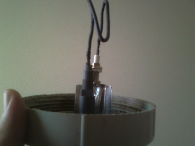

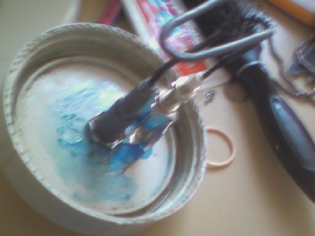

This is how mine set up i dont know why you'd need any duct tape?
You just drill a hole in your end cap big enough for it to screw in. Put a bit of silicone around it to seal it then liquid nails the bace plate under the screw so it earths out and the WA LA! you have a cheap and very efective ignition. You can pick them up from a hardware store DIY where ever your from or even BBQ shops stock them the cost about 10 to 15 dollars Australian.

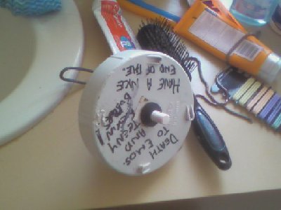

Bubba, in view of the message legible on that cap, doesn't it strike you as strangely ironic that adorning your launcher with dark rants is in itself a very emo thing to do?

(@ Bubba)
Odd.
It seems that your cannon is anti-emo, any reason for being so?
