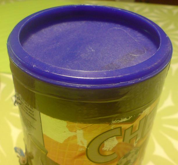

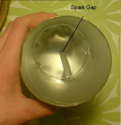

Over christmas we got a snack called cheese footballs, which came in a pringles-like tin, except it was wider (10cm diameter) and shorter (20cm). The bottom is steel and the cardboard is foil lined, and it has a pop-off lid, which is fairly tight. I ran a piece of cable through the cardboard as the spark gap (3mm spark).

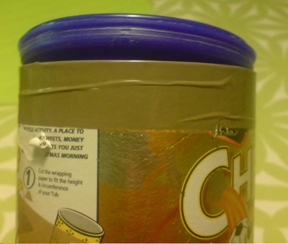

At first i used propane. A few seconds burst, then put on the lid, and most importantly, wrap tape around the lid. This creates a burst-disk like effect, and it was good.
I soon ran out of propane and found a can of butane. WOW! a few layers of tape and it is deafening if pointed in your direction. The lid fires about 5m, and then you just repeat!

- The lid before fitting. Notice it's very different from a pringles lid. This is important to let the burst disk function properly.

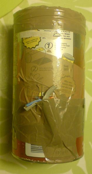

- Ready to fire! Stun gun terminals go on the stripped wire terminals.
- DSC00113.JPG (26.38 KiB) Viewed 25024 times
- The inside of the cannon
- DSC00115.JPG (22.39 KiB) Viewed 25024 times
- ...and afterwards.
- DSC00118.JPG (39.67 KiB) Viewed 25024 times

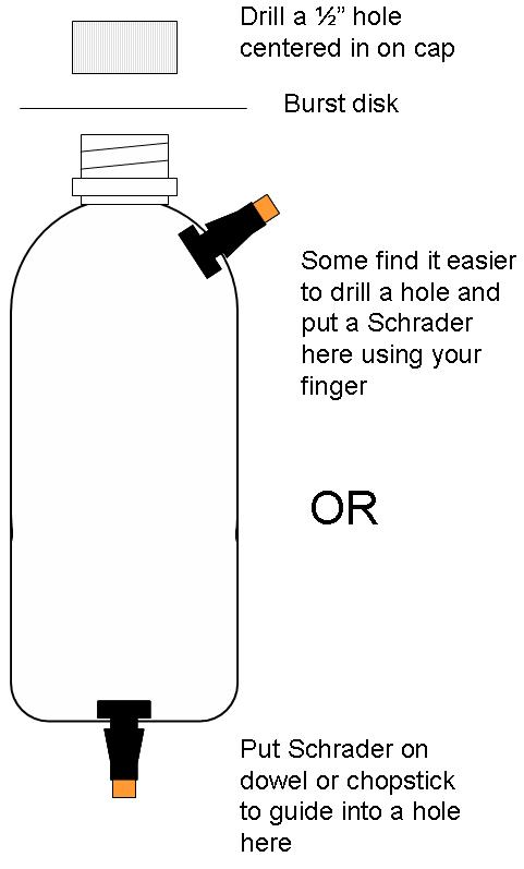

hey why don't you make a simple pneumatic burst disk device, if you don't mind pumping
- cheap burst disk device.JPG (36.26 KiB) Viewed 25003 times
Mmmm that's pretty simple too! I will have to try that tommorow.
I always find that pneumatics are quieter but of course far more reliable, choose your poison huh?
