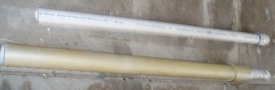

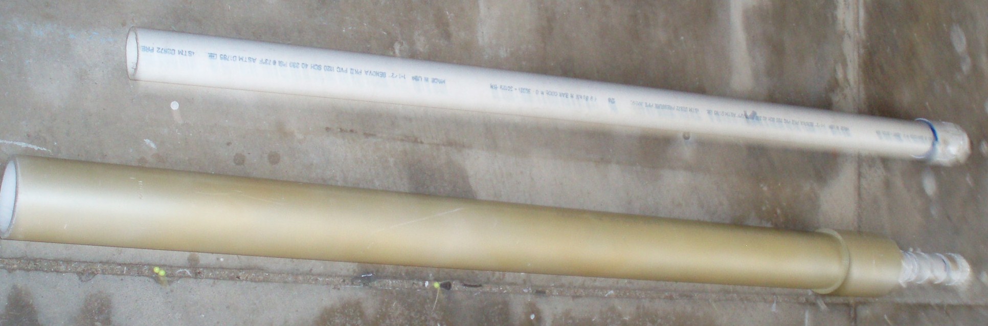

2.5'' and 1.5'' barrels both 48" long with 1'' threads to attach to chamber.

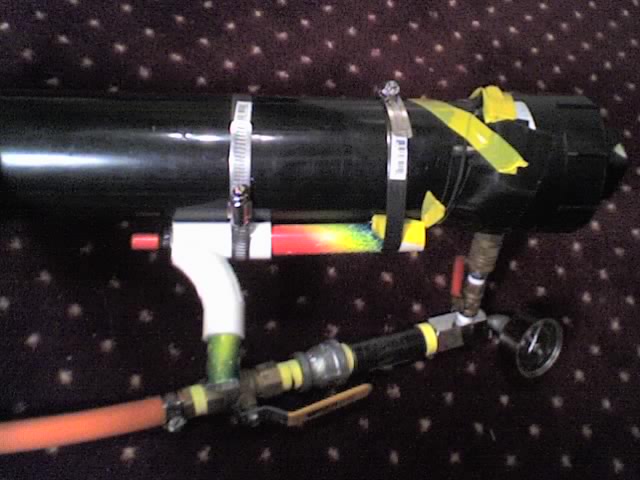

Detail of pistol grip and meter.

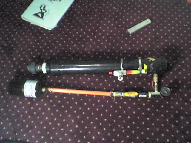

Over View of chamber, grip, and meter.
