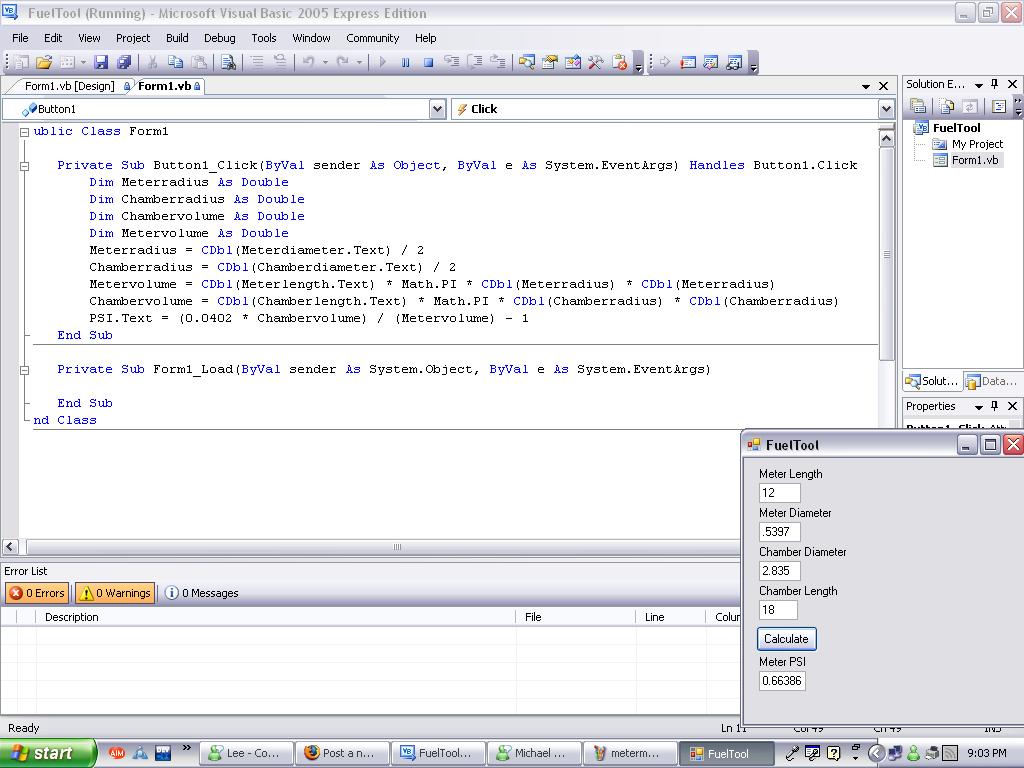

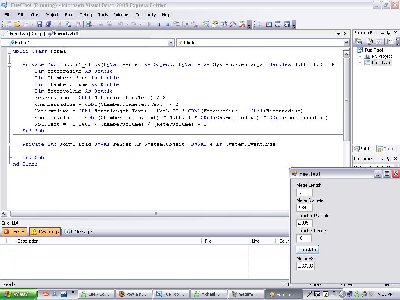

you can see the code too to see if the problem is in there, if you can understand the code

A few things
That formula you used calculates pressure in ATM, multiply by 14.7 to get psi.
Second, I'm not sure why they subtracted 1 at the end of that thread. I would think Pm = 0.042*Vc/Vm would give you the gauge pressure needed for the meter.
Making those two changes and making the chamber 19 inches like you used in the hand calculation I get the same answer that you got.
A few things you can do to simplify the program too. Since you are doing the same calculations to the chamber and meter diameters to get the chamber and meter volume and then divide the two, those calculations cancel out and you can simply use Pm = (Dc^2*Lc*0.042)/(Dm^2*Lm)

sandman, the equation you were looking for is in the first post, which is:
<div align="center"><img src="http://www.markfh11q.net/MATH/derived.gif"></div>
Second, if you're dealing with gauge pressure only, (like in a fuel tool), simply .042(V<sub>c</sub>/V<sub>m</sub>) would work. I'm still fairly certain that nobody even got the point of that thread. The whole point was simply for me to find out why you end up with gauge atmospheres when you input absolute atmospheres. And, I figured out why.
Clide, I believe the whole reason I put -1 at the end of that thread was a simple mistake. For some reason, I must have put that there and said it's the same. I'm editing it now.

Wait, change what? Make sure you got what I was saying: .042(V<sub>c</sub>/V<sub>m</sub>) will work for a fuel tool, because you're not interested in absolute pressure of the meter.

yes so i will take out the -1 that is in there now
Edit: with those changes they come within 1 PSI of each other so im happy :)
