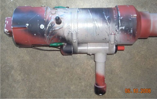

Chop the metal parts off the end of the wires on your piezo and replace with alligator clips like this;
Some heat shrink tubing makes things look nice and gives you some insulation. This design lets you move the piezo from gun to gun.
Screw a pair of fine thread drywall screws into the chamber so that their tips end up within ~1/8" of each other. The drywall screws work well, the fine thread means you have several threads actually in contact with the pvc, the sharp points make it spark more consistently.
Need a simple handle design?
This type of BBQ piezo is a snug fit inside 3/4" PVC pipe. So, a T, an end cap, a coupler, a couple short lengths of 3/4" pipe, two big-ol pipe clamps.
You can just drill a hole in the chamber and install pretty much all of the piezo in the chamber. Add a short piece of wire to one of the electrodes of the piezo to bring it closer to the other to act as the spark gap. Personnaly, I don't think its a good approach. The hole for the piezo is pretty large. The piezo itself is not air tight and will vent hot gases. The ergonomics aren't all that great, and ergonomics are important on something that is going to recoil hard enough to hurt you. Might as well make a real handle, or pistol grip, or "guano grip" or whatever works best for you.
