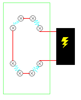

Double Edit: Just thought some more and realized, would I connect one end of the igniter to one screw in set A and the other end of the igniter to one screw in set B? Then connect one wire from the other unused screw in set A to the other unused screw in set B? Pretty sure this is it!!

This is my quick diagram for a quad-spark system.
Shouldn't need labels but if you do, just ask =]
The work of art =P
The work of art =P
ignition diagram.PNG (4.96 KiB) Viewed 7311 times
