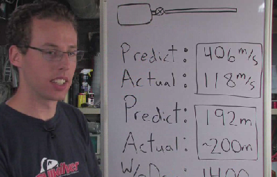

Wed May 05, 2010 9:54 pm
On a more serious side, if you have an infinate size chamber (huge) there is a simple limit to the maximum flow a barrel will provide based on diameter and length. Somewhere between medium size and infinate size, the increase in size will provide very little improvement. Keep this in mind when trying to shoot the moon with overkill.
Use GGDT and HGDT to model your creations to prevent building something impractical. For a given chamber pressure, there are practical maximum limits to chamber size where going larger does not improve things any measurable amount.
For an example showing this, here is an air cannon with too large of a chamber where a chamber less than 1/2 that size will perform almost in an identical fashion. This cannon either needs a much larger valve and barrel or smaller chamber. I have a 3 gallon launcher that will outperform this launcher with a 2 inch barrel. Chronograph measurements prove it. A better valve outperforms the huge chamber. I've launched spuds in excess of 800 FPS. The larger cannon is much slower due to the valve used. His measured spud speed is under 400 FPS. He was measuring launches at 118 Meters/Second which is only 387 FPS.
http://www.crazybuilders.com/item.php?i ... ct_section
Edit; Added a screen shot of his video to show his performance is much less than predicted.
Large cannon with 2 inch barrel.  118 Meters/Second Actual
