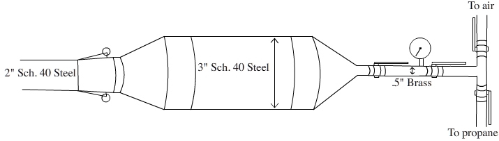

Alright- here's a sketch of what I have in mind. To fuel, I'd meter in the appropriate amount of propane Then, I'd port the proper amount of air, allowing the pressure gauge to find the pressure for the whole chamber. Is this correct? (also, forgive me for continously finding something to ask about- I simply do not want money and limbs wasted on this project :P )

Grignacke wrote:Alright- here's a sketch of what I have in mind. To fuel, I'd meter in the appropriate amount of propane Then, I'd port the proper amount of air, allowing the pressure gauge to find the pressure for the whole chamber. Is this correct? (also, forgive me for continously finding something to ask about- I simply do not want money and limbs wasted on this project :P )
Where's the burst disk / valve? You need to "hold back" the pressurized propane/air mix before it's fired, and the projectile (in 99.99% of cases) won't seal tightly enough in the barrel to do it by itself - so you need a burst disk or a piston valve, basically.

Pete Zaria,
I think he plans to use a cam-lock fitting to hold the burst disk, Its depicted in the sketch

Forgive me for my lack of burst disk. This was a sketch just so that I would get the fueling right.

true, true. So, is that a solid fueling plan?
