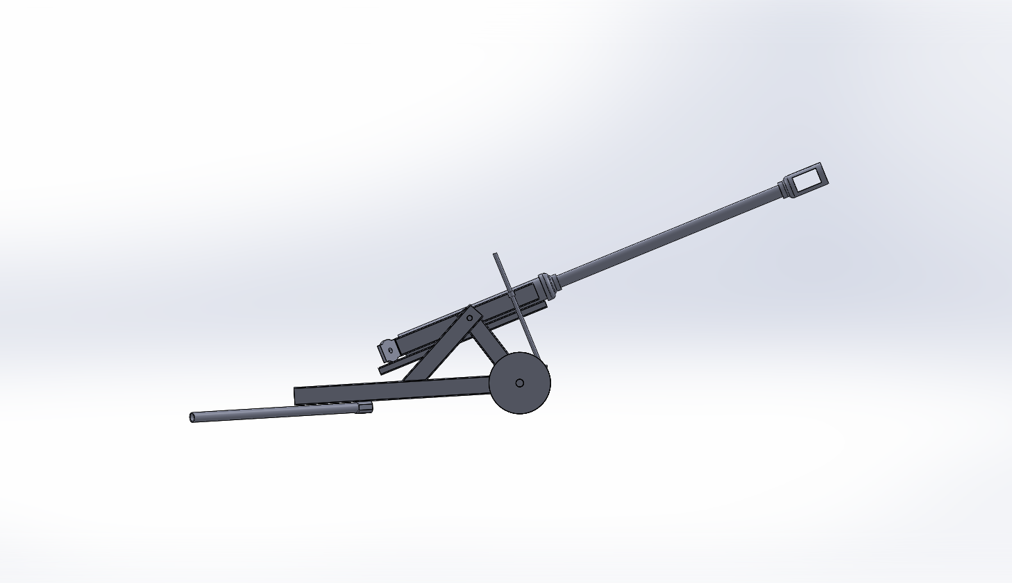

I saw a post about someone wanting to rifle a barrel for a PVC potato cannon in search for a solution myself. My friends and I had this idea to make a potato howitzer. We're taking this pretty seriously.
These are the details:
Rifled PVC sched. 80 barrel, 2"
Precharged shell w/ 3" combustion chamber
4" chamber (shell-holding)
Threaded elevation adjustment
Firing mechanism is electronic with spark plug
Muzzle break serves no purpose
For the potato-kings out there;
I'm going to use starter fluid as the propellant
barrel will be 4 feet long,
The name is 100% inappropriate, but rightly fitting. Initials are PI
Here's the solidworks working sketches;
Solidworks front view
Solidworks isometric
The shells imaged in the second photo are a little too long, and the A-frame is gonna be a tad different. We're trying to model something like the M119 but with split-legs. Don't bother lookin it up, it doesn't nearly resemble it.
