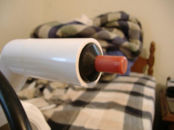

Cannon Name- The Last Blast

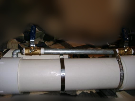

Type of Cannon- Metered Propane Combustion
Chamber Size- ~4 x 22" [5,495 mL]
Barrel Size- 2-1/2 x 60"
-Combustion
--Metered Propane Injection
--Single-gap BBQ sparker in handle
--Breech loading tennis ball barrel

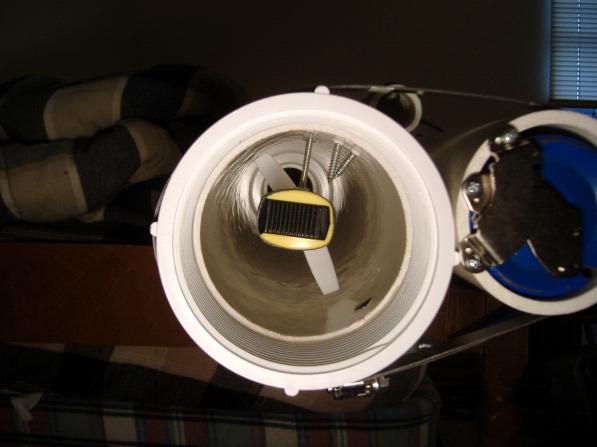

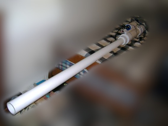

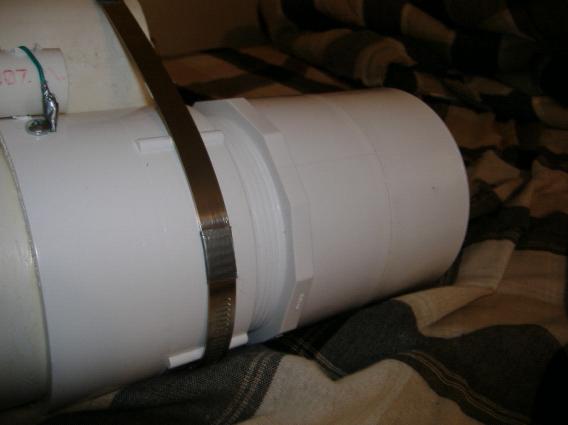

I finally finished it.
I wanted a platform to shoot tennis balls a LONG WAYS AWAY. So, this turned out to be it.
I'm going to the Slidell Wal-Mart to look for a mini camping fan for this thing. It will be a lot more powerful once I get the fan installed.
UPDATE:
I just installed the fan, (finally found one at Wal-Mart).
These fans are about 3x better than a little PC fan!!! Vents in literally moments and mixes the fuel, (even in my long-ass chamber), like nothing else. First shot was :twisted: LOUD :twisted: and left an imprint and a lot of green fibers on a log I shot it at. I found the tennis ball, and it was, of course, ruptured. 8)
And, here are some other pictures I took that aren't posted yet.
That's all the photos I'm gonna take!!! Some good videos will come shortly as soon as I can get the opportunity to take them! Remember, the small video a few posts down was taken before the addition of the fan, (HUGE boost of power). Stay tuned.

Looks good. What's the ratio on it? It could use a nice paint job of course. And the video was pretty short. How about damage from filled and frozen tennis balls?

The ratio is 0.98:1. I'm working on the water filled damage shots. 8)
I really don't feel like painting it. The entire reason I bought clear primer was so that I didn't need to paint it! A clean construction does it for me. I filed off all the lettering, (except for the handle), and then cleaned the pipe before I glued it all together.

To make it look nice without painting, just rub it down with some laquer thinner. It will take all of the lettering and dirt off, reduce the appearance of scratches, and give it a shiny finish!

Yeah, I tried a brillo pad and some Mineral Spirits, but it didn't get the lettering off. I just grabbed the file and took that stuff off.
I started to file off the letters on the fitttings, (on the barrel end), but I stopped halfway through that. I left the National Sanitary Foundation markings after I quit... because I wanted it to be a CLEAN cannon! HA HA HA HA HA - Okay, now I'll stop. :roll:

reaper613 - cleaning off lettering and dirt with mineral spirits will not weaken the PVC to any extent. Pipe cleaner is designed to do this, and it is a much more powerful solvent than mineral spirits.

Nice cannon and is that fan one of those self-cooling hand fan things for like hot days?Wont the brushes on the motor ignite the mixture?Get the damage pics of the waterfilled ball up already!
