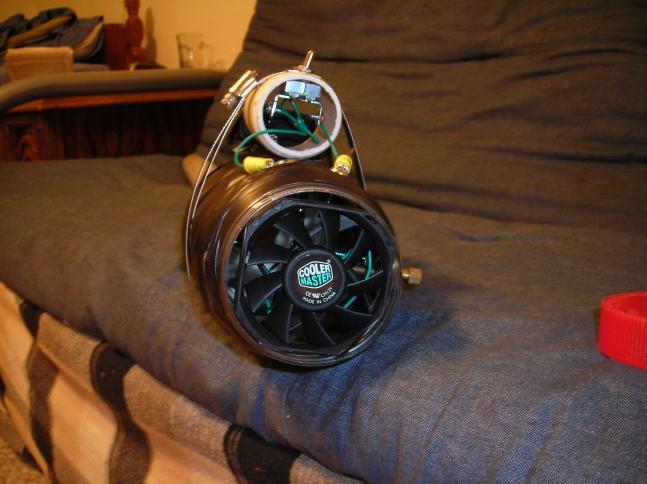

My intent here was to make a combustion spud gun entirely from scrap. I ALMOST did it, but I couldn't find a very safe alternative for a barrel.
The chamber was mad from a JIF peanut butter jar and a 2-liter bottle. The 2 liter was heat shrunk over the jar and then a 3x2" reducing coupling, which was attached to a 2" threaded breech loading assembly and a 1-1/2" SCH-40 barrel. Then, the chamber was wrapped in fiberglass resin and mat, and then electrical tape, which I can't get off now. :x A chamber fan is set-up and it has lantern igniter ignition. Here are a few pictures:
The chamber during construction
The chamber fan
The chamber fan
The chamber
The chamber
The breech loading
The breech loading
JIF
JIF
That's it. Just my own little version of insanity. :evil:
