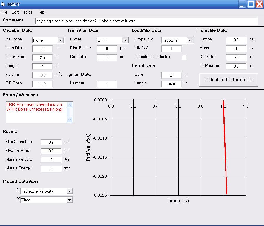

The burst disc definately matters. Have you tried it with the disc set to 0 psi?spudfarm wrote:jared is right.. i got 100m/s (333fps) more than on evbec..

D_Hall wrote:
Can ya just type over the old value rather than deleting it?
yep, no problems. I'm gonna try to get a couple of gauges tomorrow, and hopefully do some proper testing, I'm interested to see how accurate the current model is

Actually a 1" diameter lead ball only weighs 4 ozYeah, but think about it a sec... a 10 oz 1" diameter projectile? That's lead ball territory.
I think the "burst disk failure" thing needs some work; I know the piston valve I have will open at exactly 60 psi at 6x, and it seems to underestimate the performance quite a lot with that number.
But...
If the initial mix pressure is not treated as zero then it would open at 135 psi. Which is it?

I'm not sure I follow your question so I'll just say that the disc will go when the pressure differential between the chamber and the barrel is 60 psi._Fnord wrote:Actually a 1" diameter lead ball only weighs 4 ozYeah, but think about it a sec... a 10 oz 1" diameter projectile? That's lead ball territory.
But...
So... Roughly speaking, a 6X mix is initially at 88.2 psi (14.7*6). The barrel is at 14.7 psi (ambient), so the pressure differential right off the bat is 73.5 psi. Ergo, a 60 psi burst disc won't even allow you to fuel the gun without blowing the disc (if it's not giving an error, thanks, you just found one... doesn't hurt the math at all, but it should be listed as a warning or something).
With the disc going immediately and no combustion currently modeled in the barrel, I would expect extremely low velocity numbers.

Setting the burst disc to 0 with a reasonable gun gives me
ERR: Proj never cleared muzzle
WRN: Barrel unnecessarily long
