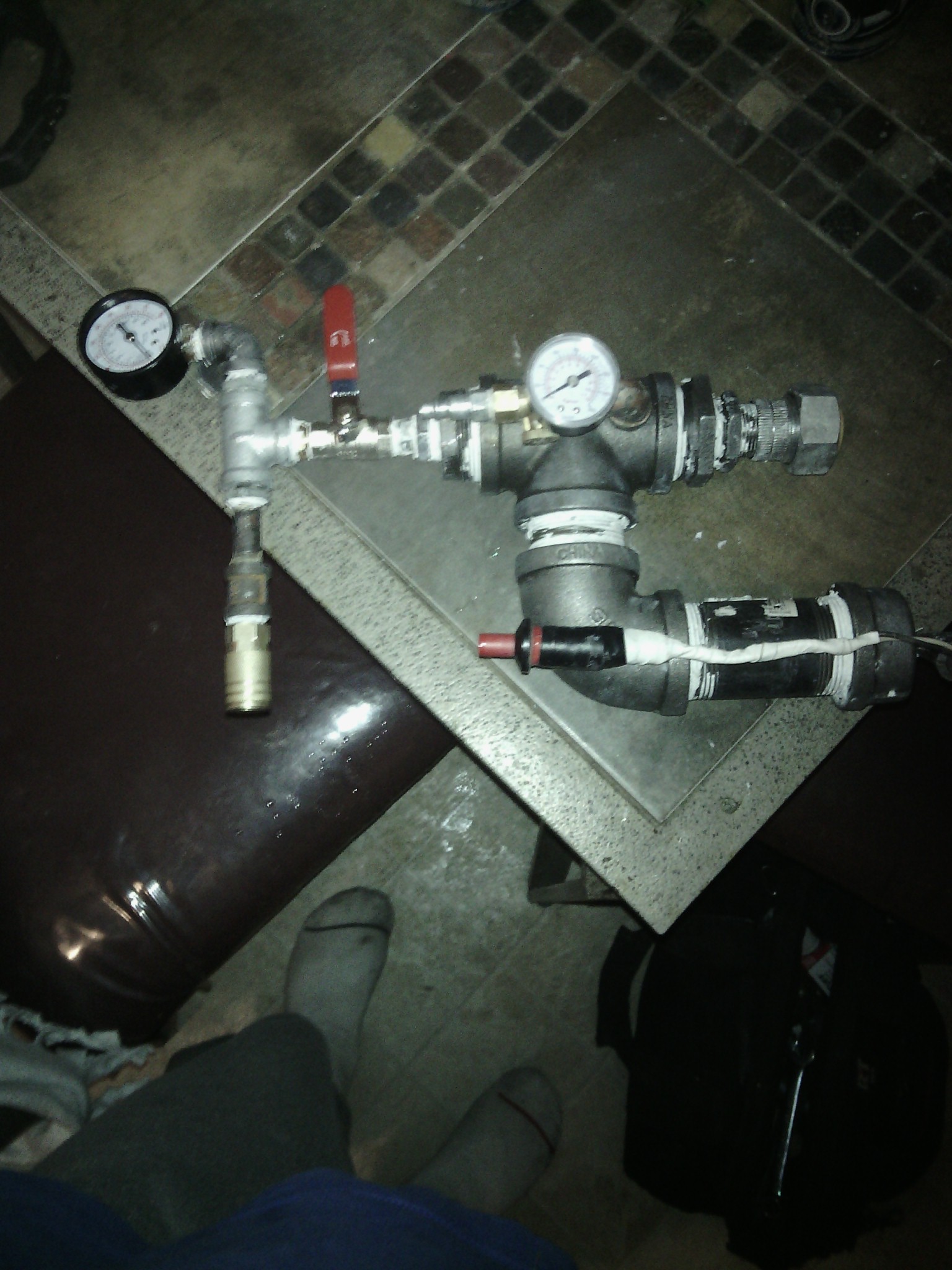

I built this cannon just today. Reason is cuz it has a much smaller chamber size than my other cannon. Now it shouldn't be an issue to shoot at higher mixes. I got the design idea from noname. I'm going to test fire it tomorrow!!

sw5amped wrote:Reason is cuz it has a much smaller chamber size than my other cannon.
What sizes are the pieces?
I look forward to seeing it in action (in pics and vids) or at least reading some details.

Mon Jan 27, 2014 8:06 pm
Looks good! Although you know instead of shrinking your chamber you can expand your propane meter to shoot at higher mixes. :wink:
That's a 1" union? What's your ammo gonna be?

Nice job, sw5amped. A little more info on the metering setup would be cool.

Hey guys..... sorry i haven't check my email in a few days because of work being so busy but thank you for all the feedback. the gun itself is all one and a half inch schedule 40 steel. it is a total of 32 cubic inch chamber. the union that you see is a three-quarter inch slip to threads. it holds a rigid copper barrel. I have another union that I use that is one inch steel thread to thread. I bought a 5 foot long 1 inch wooden dowel rod that i cut up into 2" pieces. It fits great down the one inch barrel. It's like a wooden slug.
I have a question. Sometimes when i fire a shot, usually a 4 or 5x shot, the bang is very weak and the projectile comes out slow. Is that from a bad mix or maybe my air is too lean or rich. Or do i have to make sure there are no spent fumes in my chamber.
My chamber is 32 ci. On a 1x mix i use 13 psi propane . Or on a 4x mix i use 52psi of propane and 60 air
Talk to me boys

So i fixed my problem. Come to find out that it was a gauge issue. I was filling to a whole bar to much on the air side. So at a 5x mix i had to fill to 4 bar. The gun shot absolutely mint!! I have it on YouTube. I just don't know how to post the link. Go under steve wells and hybrid#2 test
