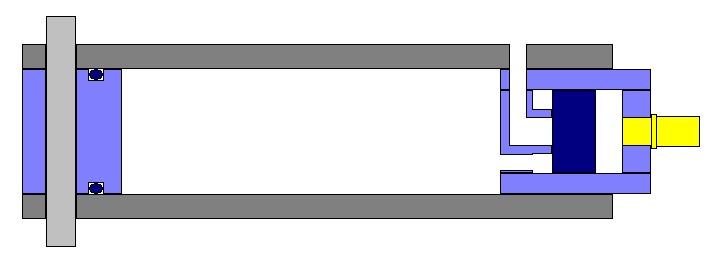

Better to add one time complexity to the fill rig than complicate every cartridge, this is how I see it:

I feel I'm missing something on that last quick exhaust fill rig sketch.
Is there another valve involved not represented?

al-xg wrote:Weren't you meant to be venting the filling chamber on disconnecting the schrader ? :?
Shock pump, independent schrader opening and disconnection.
You should use some sort of quick release plug, or even just an o-ringed threaded cap.
Yep, there are simpler ways of going about it, most of which involve turning all or part of the rig into a projectile :D
You're perfectly right, I was still thinking air spring pop-off when I drew that, and to work it would require a separate schrader. The piston would be air tight, you fill the space behind it to just enough pressure to resist the mix pressure you intend to achieve, fill the main chamber from a separate valve and it automatically pops when ready.
An actual exhaust valve as described earlied might look something like this:
